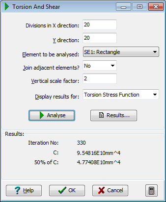

The calculations for either torsion properties, or shear properties are initiated when the F6 key is pressed or the Analyse button is clicked.
The program uses Prandtl's membrane analogy solved with a finite difference analysis using an iterative solution process. The iterations may be aborted at any time by pressing a key.
To calculate the torsion properties, click in the field labelled 'Display results for' and select either 'Torsion Stress Function' or 'Torsion Stress'. If 'Torsion Stress Function' is selected, the shape of the membrane for the torsion stress function is displayed in isometric projection. The vertical scale may be adjusted without repeating the analysis. The torsion constant is displayed in the field labelled'C'. The torsion stress is derived from torsion constant and the derivative of the torsion stress function, and the stress values plotted are for a unit applied torque of 1kNm (whatever the current units are set to).

Form Graphic
Field Help
Divisions in x direction
Divisions in y direction

Element to be analysed
The program allows you to select for analysis any of the individual elements that have been defined. The currently selected element is displayed in red.

Join adjacent elements
The currently selected element may be joined with any adjacent elements. Click in this field and set the entry to 'Yes' to join the elements, or 'No' to keep individual elements separate. In some cases (e.g. concrete U beam with slab on top) joining two elements may cause a void to be formed. Generally the program will generate this void and perform the appropriate analysis.

Vertical scale factor
This field appears only when torsion analysis is selected. When the analysis has been performed and the shape of the membrane is displayed in the graphics window in isometric projection, the vertical scale of the membrane may be adjusted by increasing or decreasing the factor in this field. The membrane is redrawn immediately, so there is no need to change this field before the analysis is carried out.
Display results for
This field controls the calculations that are performed, and the graphics display. Click on this field to display a drop-down list. The options are:
