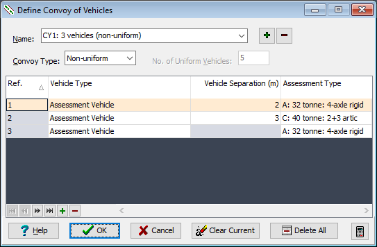

This form is used to define a convoy of vehicles. There is no limit to the number of convoys that can be defined.
A uniform convoy consists of a series of identical vehicles with equal separation between them.  A non-uniform convoy consists of a series of identical or mixed type vehicles with mixed separation.
Outline Procedure
This form is accessed from Data | Define Convoy in the main menu.
Click on the + (Add new convoy) button to define a new convoy, or select an existing convoy to edit from the field labelled 'Name'.  For a new convoy type in a name in the 'Name' field.

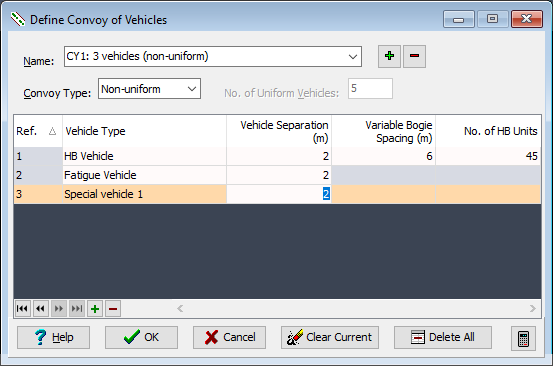

From the field labelled 'Convoy Type' select uniform or non-uniform.  For a uniform convoy specify the number of vehicles required and fill in the data required in the first row of the table. The table contains an unlimited number of rows when defining a non-uniform convoy.
The convoy is defined from left to right. The convoy is set out so that, for each vehicle, the point midway between the outermost tracks is aligned.
To add a vehicle to the table, press the + table button or the Insert key to insert a row, then complete the inserted data. To delete a vehicle from the table, press the - table button or the Delete key to delete the selected row.
To remove a convoy click the 'minus' button adjacent to the 'Name' field.
Clear Current will clear the table for the current convoy.
Delete All will remove all convoy definitions and associated loadings.

Name
Use this field to select a previously defined convoy.  For new a convoy, the program generates a short name that is used for identifying the convoy. The default name may be changed by entering an alternative name in the field. Any name over 30 characters long will be truncated in the printout of line beam envelope results.
Convoy Type
Select 'uniform' to define a uniform convoy (duplicate vehicle with equal separation), or 'non-uniform' to define a convoy of different vehicles with mixed separation.
No of Uniform Vehicles
Defines numbers of vehicles in uniform convoy.
Vehicle Type
Select vehicle type from list of available vehicles. Note 'Assessment Vehicle' cannot be mixed with other vehicle types.
Vehicle Separation
Separation is the distance between the front most axle of a vehicle and the rear most axle of a vehicle in front.
Assessment Type
Type of assessment vehicle per CS454 Appendix B. This column is visible when 'Assessment Vehicle' is selected as 'Vehicle Type' for a convoy.
Variable Axle Spacing
Vehicles can be defined with a variable spacing between one pair of axles. This dimension must be fixed when adding a vehicle to a convoy, by entering a value in this field. This column is hidden when 'Assessment Vehicle' is selected.
No. of HB Units
Enter the number of units of HB load for the standard vehicle. The default value is taken from the relevant design code. This column is hidden when 'Assessment Vehicle' is selected.
