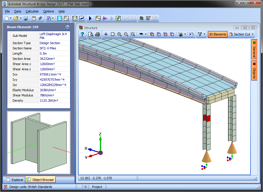

A refined analysis model can be viewed with 3D object rendering. This allows the user to check the structural integrity of the model. The 3D objects rendered include beam elements, finite elements, supports, beam releases and post tensioned tendons. Features include:
- 3D, 2D or wire frame view modes
- An Object Browser for inspecting details of a selected object (local axes and section properties, fixity, etc.). The selected object could be a beam or finite element, support or release.
- Rendering of features such as cracked beam sections, staged construction, and voided sections.
- Member colour schemes. Model can be coloured by sub model, property, elasticity or member. A colour key can be shown for the submodels or property groups.
- Member Selection Filtering.
- Cross section viewing.
- Print, save and load view commands.

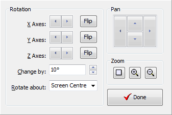

Dynamic View Menu | More...
Use this form for finer control of the dynamic view.
