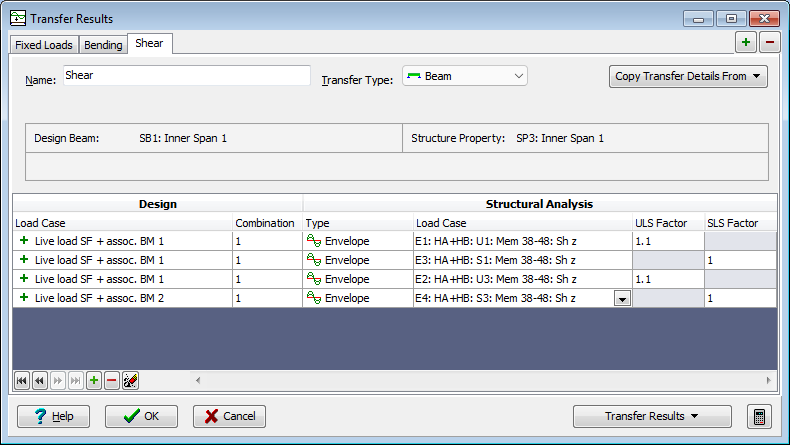

To access this form select Calculate | Transfer Results from the Main Menu. This form is used to select the result transfer location and map the load cases from the structural analysis to the load effects cases required for the design and code checking. Structural analysis result transfer can be to a Design Section or a Design Beam. The selection and load case mapping forms a transfer set. Multiple sets can be created.

For Beam and Virtual Member transfer type:
Set the Transfer Type to Beam or Virtual Member. Point to the required beam or virtual member, and click to select it. Virtual member selection is only a valid selection option for refined analysis models with virtual members defined.
The drop-down list labelled Virtual member can be used to select the virtual member non-graphically.
The selected beam or virtual member will be highlighted. When the design beam is a multi-span type, the member selected should be a member corresponding with the first span of the design beam. Clicking again on another beam will de-select the current beam, and select the new one. The details of the selected design item are shown on the form.
The left-hand side of the table lists the load effect cases required for the code checking of the design beam. The right-hand side lists the load cases from the refined analysis or the line beam analysis. For a given row of the table, the moments and forces resulting from the load case specified on the right-hand side will be transferred as load effects for the design and code checking load case specified on the left-hand side.

For all transfer types:
The procedure is therefore to set up a table of the corresponding load case data sets for the specified location. To create additional transfer sets, click on the add tab button (top-right corner of form). Selection and table details can be copied from another set using the Copy Transfer Details From button. There is no persistent link between the new and copied set.
Once the transfer sets have been defined use the Transfer Results drop down button to complete the transfer. The options depend on the currently active transfer set.

For Beam and Virtual Member transfer types, prior to transfer, the load effects are multiplied by the factors specified under the appropriate limit state columns of the table. For further details on these, refer to the field help.
The design beams allow multiple load cases for some of the design load types, namely superimposed dead loads (allowing different load factors to be applied), soil pressure loading, and all live load dead loads cases. Refer to the field help for the design load case.
For Section transfer, the load effects are un-factored when transferring analysis load cases, or factored if transferring compilations or envelopes of compilations.

Name
Enter an alternative name for the transfer set.
Transfer Type
Set the Transfer Type to Section, Beam or Virtual Member. Virtual member selection is only a valid selection option for refined analysis models with virtual members defined.

Design: Load Case (Beam Transfer)
The drop-down list contains all the load effect cases which are appropriate for the current structure type, and beam of the type currently selected, for transfer of load data.
Select the loading case for which data is to be extracted from the analysis results.
To transfer to a new design beam load case select an item from the list which has a icon. To transfer to an existing design beam load case select an item which has type icon. If a new design load case selection is made and it is a multiple load case type (namely superimposed dead loads, surfacing, soil pressure loading, and all live load variable action cases) another load case of the same type with an incremented identifier will be available in the selection list. Result transfer to an existing design load case will overwrite the existing load details.
Results will be accumulated when two or more rows of the table are set up so that they will return analysis results to the same beam design load case. This ensures that construction sequence loading can be transferred correctly for a series of analysis construction stages. This action also facilitates transfer to Ultimate Limit State 'Design' load effects from one 'Analysis' load case, and the corresponding Serviceability Limit State 'Design' load effects from another 'Analysis' load case.

Design: Combination (Beam Transfer)
Select the load combination (1 or 3) as required. This field applies to the Bending Moment and Shear Force live loadings only. Where non-applicable loadings are selected, the value entered has no effect.
Structural Analysis: Type
Select 'Load' from the drop-down list to enable selection of basic load cases, or 'Compilation' to enable selection of compilation load cases, or 'Envelope' to enable selection of envelopes.
Structural Analysis: Load Case
This column is visible only if this form has been accessed from the Main Menu using Calculate | Transfer Results following analysis of the structure and selection of a beam.
The drop-down list contains a list of all the load effect cases of the type specified in the previous field.

Limit State: ULS (Beam Transfer)
Limit State: SLS (Beam Transfer)
For design beam transfer, the factors by which the load effects will be multiplied prior to transfer are specified in the two fields under the columns headed ULS and SLS. The defaults are based upon DMRB BD 37/01 and may be one of the following:
  • a value equal to γfL x γf3 appropriate to the load case type and combination selected in the first and second columns respectively of the table.
  • a value equal to γf3 only unless the current beam is a steel composite beam (in which case γf3 is included in the code checking formulae).
  • for compilation load cases, values of 1.0 and 0.0. This occurs, for example, if the program has detected that a compilation case has been compiled for ULS and includes non-unity γfL factors. In this case the ULS factor will be set to 1.0, and the SLS factor to 0.0.
If a compilation load case has been compiled with the factors for all of the constituent loadcases set to 1.0, then a different value of load factor may be set for both ULS and SLS. In this case the program will attempt to select an appropriate default value based on the load case type, and the contents of the selected compilation or envelope.
Any of the default values may be overwritten.
