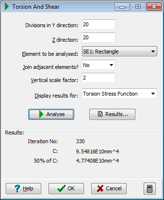

Form Graphic
Field Help
Divisions in y direction
Divisions in z direction
The number of divisions for the finite difference mesh must be entered for the y and z directions.
For sections whose overall dimensions fit into an approximately square shape, and which do not have a lot of details in them, the default values of 10 x 10 give a very good result.
For sections containing voids a finer grid may be needed.
For thin walled sections, the grid should be arranged so that a minimum of 3 grid points occur within the width of the material, (or 2 between the outside of a section and a void may suffice for torsion properties).
The solution time is approximately a function of the grid size squared. Although there is in theory no limit to the fineness of the grid, in practice the solution times can become exceedingly long, and in addition the program automatically adjusts the convergence for the iterative solution, so there is no benefit in having a finer mesh size than necessary.
Element to be analysed
The program allows you to select for analysis any of the individual elements that have been defined. The currently selected element is displayed in red.
Alternatively the currently selected element may be joined with any adjacent elements (refer next field).
Join adjacent elements
The currently selected element may be joined with any adjacent elements. Click in this field and set the entry to 'Yes' to join the elements, or 'No' to keep individual elements separate. In some cases (e.g. concrete U beam with slab on top) joining two elements may cause a void to be formed. Generally the program will generate this void and perform the appropriate analysis.
If the void is not generated, separate the elements (set the entry in this field to 'No') and try joining with the other element specified in the previous field.
Vertical scale factor
This field appears only when torsion analysis is selected. When the analysis has been performed and the shape of the membrane is displayed in the graphics window in isometric projection, the vertical scale of the membrane may be adjusted by increasing or decreasing the factor in this field. The membrane is redrawn immediately, so there is no need to change this field before the analysis is carried out.
Display results for
This field controls the calculations that are performed, and the graphics display. Click on this field to display a drop-down list. The options are:
