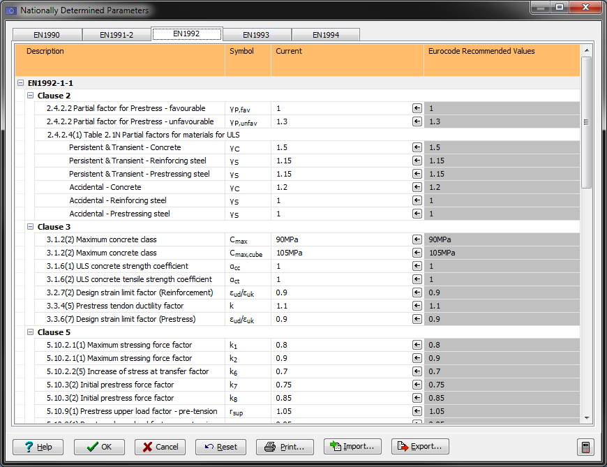

This form allows the user to inspect and edit the Nationally Determined Parameters (NDPs).
This one form contains several tabbed pages. Each page shows parameters relating to a specific Eurocode.
The 'Current' column shows the parameters currently applying for the current model. The right-most column, which also cannot be edited, shows the parameters specified by the currently selected National Annex.

Edit values displayed in the 'Current' column if necessary. Edited values are checked and warnings given where they are outside the expected range. Alternatively, use the
button to transfer the National Annex value to the 'Current' field.
The Reset Current NDPs button sets all parameters to recommended values following confirmation.
Edited values are stored and used in analysis and load optimisation and are saved in the current data file.
The Print NDPs button brings up a 'Text View' of all the NDPs, in printable format, in which the font type and size may be modified. The 'Text View' may be converted to 'PDF View' with a wide range of formatting and print options.
