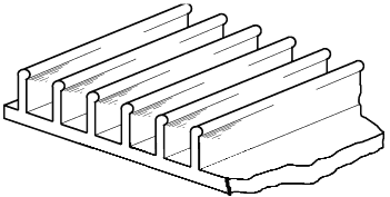

Fabricated Materials
A shell may be formed from a fabricated material such as a plate with closely spaced stiffeners.
An example calculation of the elasticity matrices for this equivalent material is given below.
A single set of orthotropic properties cannot be found to describe such 'materials' because their membrane and bending responses are very different. Instead, both the membrane and bending elasticity matrices must be specified directly for each element. These matrices are determined both by the material properties of the shell and by the shape of the section.

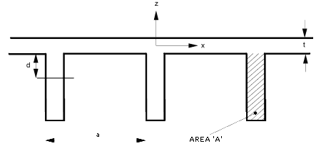

As an example we show how the elasticity matrices of a plate with stiffeners on one side can be calculated.
Let the shell have a cross section of the form:
where:
A denotes the separation of the stiffeners
D denotes the depth of centroid of a stiffener below the bottom surface of the plate
A denotes the cross sectional area of a stiffener
t denotes the thickness of the plate
To complete the specification of the stiffeners we require:
Ib which denotes the inertia for major axis bending of a stiffener, and
Ix which denotes the torsional constant for a stiffener.
The shell is modelled by elements such that the stiffeners run in the local y axis direction of each element. Both the plate and the stiffeners are of the same material with Young's modulus (E) and Poisson's ratio (ν). The torsional modulus of the material (G) is used to calculate the torsional stiffness of a stiffener.
