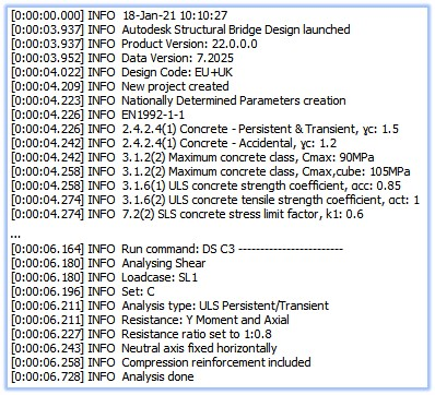

Log
The progress log is a text file that provides a detailed record of the model data and commands as they are processed during the automation run. It also includes any warnings or errors encountered during that process. The log file is useful for troubleshooting and understanding the execution flow of the automation.
Log

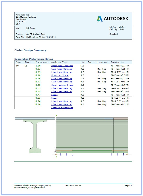

Report
The design report is an optional output in PDF format that provides a comprehensive overview of the calculations performed for a section or beam. It includes detailed information on the design calculations, such as critical effects, performance ratios, and other relevant parameters. The report often includes hyperlinks that allow easy navigation between the summary table and the detailed calculations, providing a comprehensive understanding of the design analysis.
Design Report
