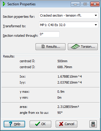

Section Properties Analysis
Description
The principal results are displayed (after a comprehensive series of data checks).
More detailed results are available in the printout, which can be viewed on the screen by pressing the F5 key or clicking on the Results button.

Form Graphic
Field Help
Section properties for
Click on this field to display a drop-down list containing a comprehensive list of options as follows:
- The entire member cross section ignoring reinforcement
- The entire member cross section including reinforcement transformed on the basis of modular ratio
- The area of the cross section in compression together with the tension reinforcement, transformed on the basis of modular ratio
- The area of the cross section in compression together with all the reinforcement, transformed on the basis of modular ratio
- The plastic section properties of the cross section
Note that for the first option, as well as ignoring the reinforcement, any different modulus values for different concrete elements are also ignored.
In all cases tendons are ignored. Where both short term and long term values of elastic modulus are specified (i.e. for concrete properties) the short term value is used.
Generally for structural analysis using a grillage or frame model, properties based on the uncracked section may be used. Refer to Article 4.5.2.2 and associated commentary of AASHTO LRFD.
Transformed to property set ref
This field enables the material property set that will be used as a basis for the modular ratio calculations to be selected. This will normally be the material property set corresponding to the lowest elastic modulus.
Section rotated through
Prior to calculating the section properties, the section will be rotated through the angle specified in this field. Thus, to calculate the cracked section properties for the section with negative applied moment, for example, enter a value of 180°.
Axial
When the analysis is for plastic section properties, this field will be available enabling an axial load to be specified, the presence of which will reduce the plastic moment of resistance. The value may not exceed the plastic squash load, and the program will check and warn if this limit is exceeded.
