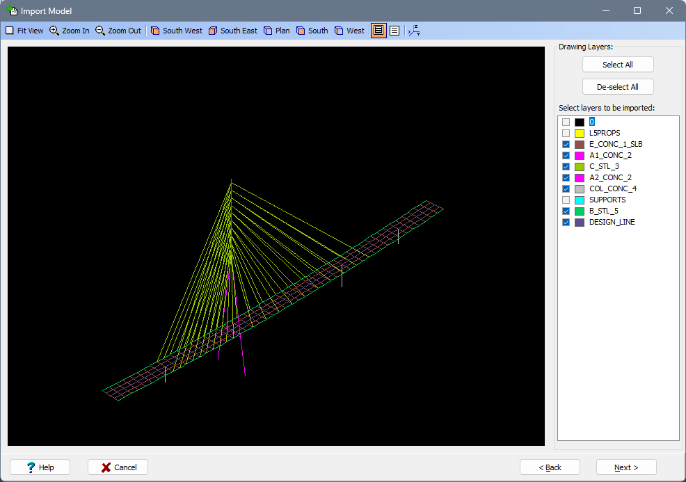

DXF Import Data
Description
This form is used to select layers when importing Autodesk® AutoCAD Exchange (DXF) files. AutoCAD Exchange files can be used to import structure, design line and section coordinate data.
Import Model
All of the layers in the DXF are presented. The program will scan the selected layers for LINE entities, which it will read in as beam members, and for 3DFACE and SOLID entities, which it will read as finite elements. All other entities are ignored.

Form Graphic
Field Help
Graphics Toolbar
Allows the graphics display to be manipulated.
Drawing Units
Allows the user to select the units that the drawing file will be imported in. This option does not appear on the form when importing a structure.
Drawing Layers
Allows the user to select the layers that are required for import. Only one layer may be selected when importing a design line. The base layer is selected by default.
