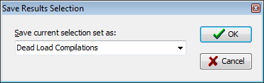

A selection of members can be saved for future use as a 'Member Selection Set' by clicking on Save (to bring up a 'Save Member Selection' sub-form), entering a name and clicking OK to confirm.

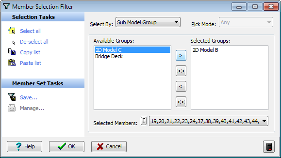

Select By
Selections may be made from specific sources according to the selection made from this field. The available options are:

Available Groups
Lists all the Groups of members that match the current 'Select by' option. These can be dragged and dropped to the 'Selected Groups' pane, in which case their members are added to the 'Selected Members'.
Selected Groups
The current selection of groups from which the members have been added to the 'Selected Members'.
Selected Members
The current selection of members (or 'Member Selection Set'). Managed by the Assignment Controller, which allows selection from a drop-down list of all members or definition of a selection by text formula.

Select this command to display the Save Member Selection sub-form. This allows a name to be defined for the current selection, which is then saved within this data file. The name becomes available for use as a member selection set in future filtering on clicking OK to exit the sub-form and confirm.

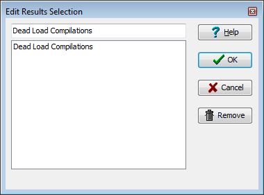

The member selection set name may be modified by selecting the set (click on the set name in the list) and then changing it in the top field.
A selected member selection set may be deleted by clicking the Remove button. A warning is given.
Clicking OK confirms the changes.
