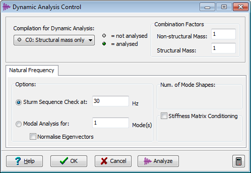

Using this form
This form is divided into two panels. The upper panel defines the dynamic compilation that is to be analyzed and it should be used first.
The 'Compilation for dynamic analysis' drop-down menu lists all dynamic compilations (created using the 'Compile Loading Patterns-Dynamic' form). The menu additionally always contains the compilation 'C0: Structural mass only' that comprises only the masses defined by material densities specified via structural properties. A green bullet placed alongside each item in the menu indicates that the item has been, and remains, modally analyzed. Only the dynamic compilation that has been selected and so is shown in the 'Compilation for dynamic analysis' field may be considered or analyzed at any given time.
The 'Combination Factors' box contains two fields. Loading from the lumped masses included in the compilation currently shown in the 'Compilation for dynamic analysis' field is multiplied by the entry in the 'Non-structural mass' field. Loading from structural mass (dynamic compilation 'C0: Structural mass only') defined by material densities specified in section properties is multiplied by the entry in the 'Structural mass' field. Then the two sets of mass loadings are summed to create the total mass loading used for dynamic analysis. By default both 'Combination Factors' fields are set to 1 (in which case loadings are applied as entered).
The 'Natural Frequency' (lower) panel should be used in two distinct stages (and only after the upper panel is set). The first stage is to undertake a Sturm sequence check at a specified frequency (by selecting the 'Sturm sequence check at' radio button, setting the required frequency in the corresponding field and then clicking the Analyze button). Following the Sturm sequence check the 'Num. of mode shapes' field displays the number of mode shapes (of this structure and using the mass-loading defined in the upper panel) whose natural frequencies are lower than the Sturm sequence check frequency. In a few instances, if the specified frequency is almost a natural frequency, the check will fail and a slightly different frequency should then be specified.
The second stage is to select the 'Modal Analysis for' radio button and then to enter into the corresponding 'Modes' field the number of modes of vibration for which dynamic analysis is required. Clicking the Analyze button then starts the analysis. When analysis is complete the dot alongside the current 'Compilation for dynamic analysis' becomes green and the Result button is enabled such that clicking on it displays a listing of Eigenvalues, natural frequencies and participation factors for each mode. The number of modes should be checked to ensure that it matches the number predicted by the Sturm sequence check. Deflected shapes for the current 'Compilation for dynamic analysis' may now be viewed in the Tabular Results form.
In some cases inversion by Cholesky decomposition fails due to ill-conditioning or when the structure has insufficient support and a listing describing the error is displayed. The problem might be overcome by checking the 'Stiffness Matrix Conditioning' checkbox and then entering a small value in the range -1E-6 to +1E-3 into the 'Shift by' field.
Form Graphic
This drop-down contains a list of the names of all currently defined dynamic compilations (created using the Compile Loading Patterns-Dynamic form). The list additionally always contains the compilation 'C0: Structural mass only' that comprises only the masses defined by material densities specified in section properties. A green bullet placed alongside each item in the list indicates that the item has been, and remains, modally analyzed.
Selecting an item in the list causes that dynamic compilation to become currently active. Only the currently active compilation may be considered or analyzed at any given time.
Combination Factors: Non-structural mass
Loading from the lumped masses included in the compilation currently shown in the 'Compilation for dynamic analysis' field is multiplied by the entry in this field before being summed with factored loading from structural mass to create the total mass loading used for dynamic analysis. By default this field is set to 1 (and thus loadings are applied as entered).
Combination Factors: Structural mass
Loading from structural mass (dynamic compilation 'C0: Structural mass only') defined by material densities specified via structural properties is multiplied by the entry in this field before being summed with factored loading from non-structural mass to create the total mass loading used for dynamic analysis. By default this field is set to 1 (and thus loadings are applied as entered).
The first stage of analysis of a selected dynamic compilation is to undertake a Sturm sequence check at a specified frequency by (i) picking this radio button, (ii) setting the frequency in this field and then (iii) clicking the Analyze button. A scrolling display shows the status of the check and is closed on completion of the check by picking the Done button. Following the Sturm sequence check the Num. of mode shapes field displays the number of mode shapes (of this structure and using the mass-loading defined in the upper panel of this form) whose natural frequencies are lower than the Sturm sequence check frequency.
The principle functions of the Sturm sequence check are:
- To verify that the program has not missed any natural frequencies in the range of results that it has obtained.
- To test multiple eigenvalues.
- To test for 'free degrees of freedom'
Num. of mode shapes
This field is set automatically following a Sturm sequence check. It shows the number of modes of vibration that have a natural frequency lower than that specified in the Sturm sequence check at field.
Modal Analysis for
The final stage of analysis of a selected dynamic compilation is to (i) select this radio button, (ii) enter into the corresponding 'Mode(s)' field the number of modes of vibration for which dynamic analysis is required and then (iii) click on the Analyze button. A scrolling display shows the status of the analysis and is closed on completion by clicking the Done button.
When analysis is complete the bullet alongside the current Compilation for dynamic analysis becomes green and the Result button is enabled such that clicking on it displays a listing of Eigenvalues, natural frequencies and participation factors for each mode. The number of modes should be checked to ensure that it matches the number predicted by the Sturm sequence check and shown in the Num. of mode shapes field. Deflected shapes for the current 'Compilation for dynamic analysis' may now be viewed in the Tabular Results form.
Normalize Eigenvectors
If this box is checked then the scale of the displacements in the results is modified so that the maximum displacement in each mode is changed to 1.0 (net effect of DX, DY and DZ). All other displacements and rotations are factored accordingly so that they are a proportion (smaller than 1.0) of the maximum displacement.
In some cases inversion by Cholesky decomposition fails due to ill-conditioning and a listing describing the error is displayed. The error might be overcome by checking this checkbox and then entering a small value into the Shift by field.
Shift by
In some cases inversion by Cholesky decomposition fails due to ill-conditioning and a listing describing the error is displayed. The error might be overcome by ticking the Stiffness Matrix Conditioning checkbox and then entering an arbitrary small value in the range -1E-6 to +1E-3 into this field.
Entering a 'shift' value affects only the dynamics results. It has no effect on static analyses of the same model.
Large positive shifts affect the accuracy of the results. Negative shifts reduce the stability of the solution.
In applying the shift the program adds (the mass matrix times a multiple of the shift) to the stiffness matrix. This helps to produce a non-singular stiffness matrix. The results presented to the user are adjusted accordingly.
Result
This button is enabled only after 'Modal Analysis' is completed. Clicking on it displays a listing of Eigenvalues, natural frequencies and participation factors.
Analyze
Clicking this button starts either a Sturm sequence check or a Modal Analysis.
