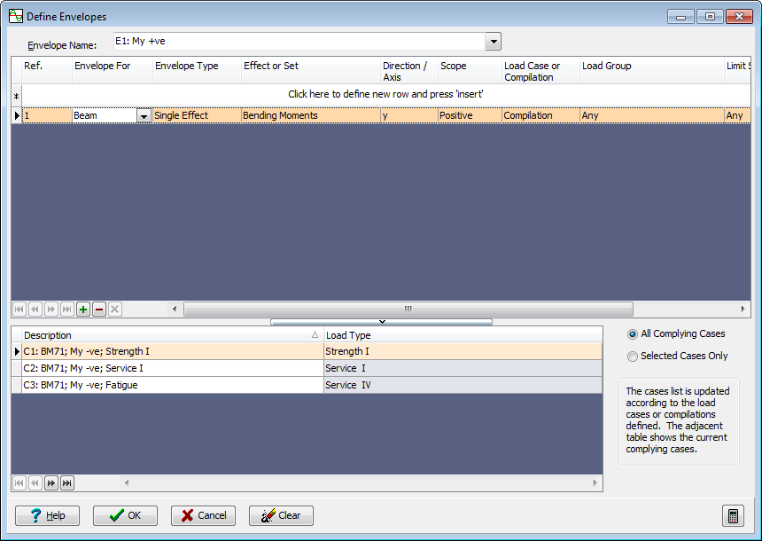

The envelope of a given load effect at a given point on a given structural element is the extreme maximum or minimum bound of all the results for that load effect at that point on that element for a given selection of load cases and load compilations.
This form is divided into two tables. Each row in the upper table defines one envelope. For each envelope there is a corresponding list, displayed in the lower table, of the load cases or compilations whose results for a given effect are to be compared to find the most extreme results (the result envelope for that effect).
The upper table (fundamentally) defines the effect whose results are enveloped. Subsidiary columns in the upper table define conditions that allow the user to filter the load cases or compilations listed in the lower table such that (for instance) only load compilations for a particular type of highway loading are considered when creating a particular envelope.

To define an envelope :
  1. Click on the panel of the upper table labeled Click here to define new row and press 'insert' (alternatively use the Insert Record button at the bottom of the upper table). The area becomes a template row of the upper table with a default 'Ref'.
  2. Define each of the cells in the template row (as described in the field help of this form).
  3. Click on the Insert Record button of the upper table. The row is added to the upper table to become the currently active row. The lower table is populated automatically with all load cases or combinations complying with the conditions defined in the new row of the upper table.
  4. The new envelope (row) has automatically been given a default name that is displayed in the Envelope Name field. It can be edited to any alternative name. But 'E' and the envelope reference number are always prefixed to the final name.
The lower table will list all the load cases or compilations filtered according to the defined envelope details. Note that this is a dynamic list, and will be updated if further load cases are defined, whether or not the envelope details are viewed again from this form.
To define an envelope manually:
  1. Having carried out stage 1 to 4 above, Click on the Selected Cases Only radio button.
  2. Click on the Clear Cases button. Acknowledge the warning. The lower table is emptied.
  3. Click with the mouse on the panel of the lower table labeled Click here to define new row and press 'insert' (alternatively use the Insert Record button at the bottom of the lower table). The area becomes a template row of the lower table.
  4. Click in the leftmost column of the template row. The drop-down that appears lists all the load cases or compilations complying with the conditions defined in the new row of the upper table.
  5. Click on one of the required load cases or compilations for the envelope. It is added to the lower table.
  6. Continue until the table defines the full required set of load cases or compilations.

Field Help
Envelope Name
This field displays the name of the envelope defined in the current active row of the upper table.
When a new envelope has been posted in the upper table it becomes the current active row and a new short default name, generated automatically, is displayed in this field.
Clicking the left mouse button with the cursor over this field causes the prefix ('E' and reference number) to be removed and the rest of the name to become editable. Normal text entry can be used to create any chosen name. On leaving this field (so it looses focus) the newly defined name is displayed but prefixed with 'E' and the envelope reference number.
Clicking the left mouse button with the cursor over the right-hand (drop-down) icon of this field causes a drop-down list of the names of all currently defined envelopes to be displayed. Clicking the left mouse button with the cursor over an item in the list makes that envelope the currently active row in the upper table.
Ref
Envelope reference number. Display only not editable.
Envelope For
Click and select the results type that is to be enveloped. Menu items correspond to the results types for tabular results. (These may be thought of as groups of structural elements.)
Envelope Type
Click and select the envelope type from the following options:
Effect Description
Single Effect Envelopes the results of a single defined effect only (e.g. Bending Moments, y, -ve).
Associated results (in other columns of the same row) will be results (for other effects) that occur concurrently with the most critical case for the enveloped effect (the envelope result).
Enveloped results are available (identified by Member/Joint references) for each structure element complying with the defined Result Type (see Envelope For above).
All Effects Creates enveloped results for all effects. Each column in the results table allows access to enveloped results for its effect; but enveloped results for just one critical effect (column) are displayed at any one time.
Associated results (in other columns of the same row) change according to which column is currently displaying enveloped results. They will be the results (for other effects) that occur concurrently with the currently displayed critical effect.
Enveloped results are created (identified by Member/Joint references) for each structure element complying with the defined Result Type (see Envelope For above).

Load Case or Compilation
Click and select the load type that is to be enveloped. The options presented are:
  • Load Case
  • Compilation
Load Cases and Compilations cannot be mixed in Envelopes. In order to envelope a Load Case with compilations then the Load Case must be incorporated into a new compilation using the Compile Loading Patterns form and the resulting compilation enveloped with others.
Load Group
The Load Cases or Compilations in the envelope may be filtered according to the type of loading. Click and select from the options presented, which are described below:
For 'Load Case'
  • Any   Includes any loading in the complying load cases
  • Live   Includes only live loads in the complying cases
  • Non-Live   Includes only non-live loads in the complying cases
For 'Compilation'
  • Any   Includes any complying compilation
  • Live Compilations   Includes only complying live compilations
  • Dead Compilations   Includes only complying dead compilations
  • Other items in menu   All compilation types currently defined in the Compile Loading Patterns form but with individual items for dead loadings removed
Limit State
This field is not applicable for Load Cases.
The Compilations in the envelope may be filtered according to the limit state. Click and select from the following options:
  • Any   Includes both Strength and Serivce Limit States in the complying compilations
  • Strength   Includes only Strength Limit State in the complying compilations
  • SLSService   Includes only Service Limit State in the complying compilations
Construction Stage
This column is shown if multiple construction stages have been defined. Select a construction stage from the drop-down list. The Compilations in the envelope will be filtered according to the selected stage. Note for Load Cases, only final construction stage loads can be selected.
Description
This column contains descriptions of either all the load cases or all the compilations (depending on which type is selected in the upper table) included in the envelope currently active in the upper table.
If Selected Cases Only is currently applied then click in this column and select from the list displayed of all the load cases or compilations (as applicable) currently complying with the conditions defined in the upper table. Selecting an item from the drop down adds it to the load cases or compilations included in the current envelope. (Note: A check is made so that items are not included twice).
Load Type
This column contains descriptions of either load cases or compilations (as appropriate).
All Complying Cases
Selected Cases Only
The selection from this radio-button pair is applied to the currently active envelope (the highlighted row in the upper table) and saved with it.
  • All Complying Cases
    The lower table lists all those load cases or compilations that comply with the conditions set in the currently active envelope row in the upper table.
    This is the default on creation of a new envelope.
    If All Complying Cases is selected for a presently 'Selected Cases Only' envelope a warning is displayed. Acknowledging 'Yes' clears the currently selected cases and replaces them with 'All complying cases'.
  • Selected Cases Only The lower table lists a subset selected from all those load cases or compilations complying with the conditions set in the currently active envelope row in the upper table.
    Note that this is a static list, and the list will remain constant until items are manually added or deleted on this form.
    The lower table Insert Record button and Click here to define new row and press 'insert' are both displayed and active.
    If Selected Cases Only is selected for a presently 'All Complying Cases' envelope then the content of the lower table is left intact. A true selection is created by first emptying the lower table using the Clear Cases button and then using the Insert Record button or Click here to define new row and press 'insert' to define a series of selected load cases or compilations chosen from the drop-down lists in the 'Description' column of the new row.
Find Cases
This option is applicable to the 'Single Effect' envelope type only.
Find Cases compares results to assess which compilations or load cases provide critical cases for the currently active envelope (the highlighted row of the top table). Only those load cases and compilation contributing to the bounds of the envelope for any element for the given load effect are critical (and thus included in the list of found cases).
Before Find Cases is used the structure must have been analyzed using Calculate | Analyze of the application main menu.
Operation of Find Cases is described in the procedure section above.
Find Cases generates an entirely new lower table content, deleting existing content.
Clear Cases
This button is available for Selected Cases Only.
Clicking the left mouse button with the cursor over this button brings up a warning. On acknowledging 'Yes' the entire content of the lower table is cleared.
Clear
Clicking on this button brings up a warning. On acknowledging 'Yes' ALL envelope definitions are removed.
