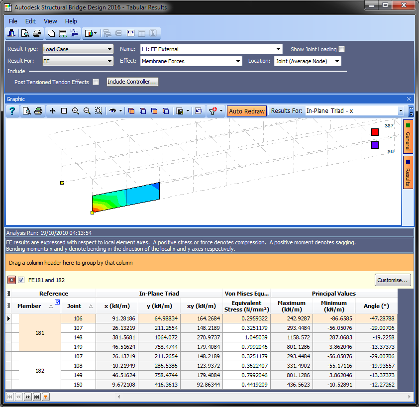

Tabular Results
Description
Tabular results are displayed and can be selected, manipulated and output to printer or spreadsheet using this form. Graphical results may also be displayed, manipulated and output.
Outline Procedure
This form is accessed using File | Results from the Main Menu. It can only be accessed if the model has been analyzed. It opens with a display of the last-used selection and format of results (if available). Otherwise it opens with a default set.
Results are manipulated within this form by:
- Adjusting the Form Layout
- Selecting Results to Display
- Adjusting the Table Layout and Content
- Adjusting the Graphic
- Creating Output
Form Graphic
