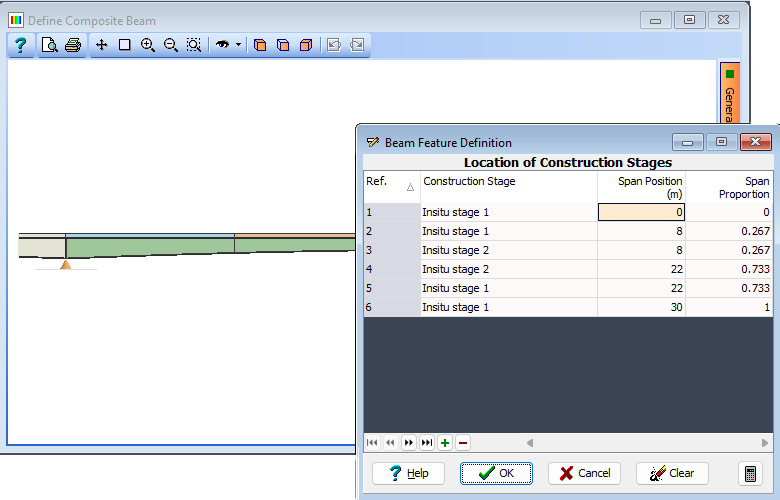

Define Construction Stages
  1. Enter a value of “2” in the No. of construction stages field. Click on the Define and locate span features drop down menu and select “Construction Stages” from the list to open the Beam Feature Definition form.
    • Click on the Clear button to delete the current data.
    • Click on the table + button 6 times.
    • On the first row of the table, click in the Construction stage drop down menu and select “Insitu stage 1” from the list.
    • On the second row, select “Insitu stage 1” and enter a value of “8m” in the Position along span field.
    • On the third row, select “Insitu stage 2” and enter a value of “8m”.
    • On the fourth row, select “Insitu stage 2” and enter a value of “22m”.
    • On the fifth row, select “Insitu stage 1” and enter a value of “22m”.
    • On the sixth row, select “Insitu stage 1” and enter a value of “30m”.
    • Click on the ✓ OK button to close the Beam Feature Definition form.
  2. Click on the ✓ OK button to close the Define Composite Beam form.
