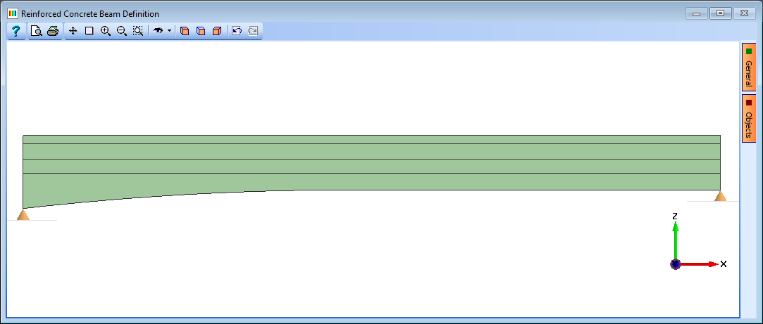

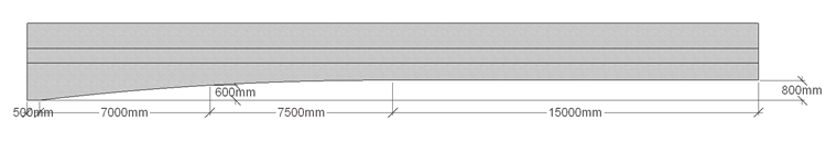

Create a uniform RC beam 30m long using the section shown below. The material for the beam is grade C40/50 concrete. Ensure that the soffit is defined in the section.
The beam has a soffit profile as shown below .
| Soffit Coordinates | Point | |
| A | 0.00 | 0.00 |
| B | 7.00 | 0.60 |
| C | 15.00 | 0.80 |
| D | 30.00 | 0.80 |
Place 4 rows of 40mm diameter bars in the bottom face, parallel to the soffit and two rows in the top face (on the underside of the rebate). Cover to the outer faces of the concrete should be 50mm with 50mm between rows and each row should contain 15 bars.

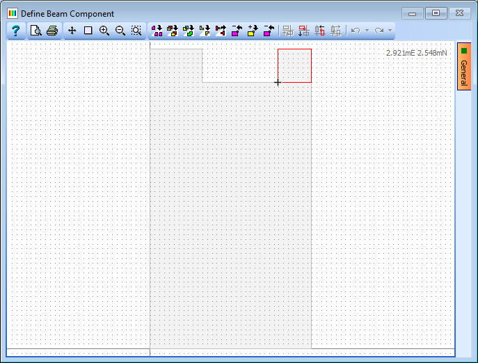

Click the table insert + button and select “Parametric shapes” from the component column list. This will open the Define Reinforced Concrete Beam Component form. Select “Rectangle” from the Shape Reference drop down menu. Enter a value of “1700mm” in the width field and “2800mm” in the depth field. Click on the ✓ OK button to close the Define Reinforced Concrete Beam Component form.

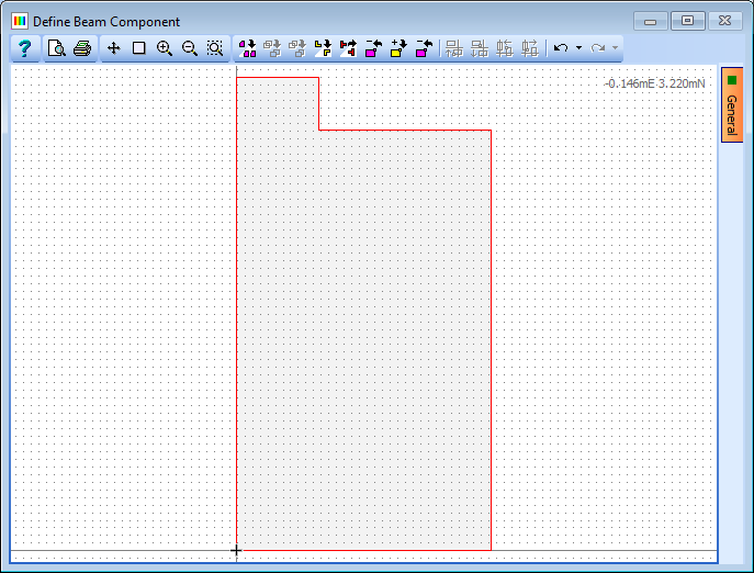

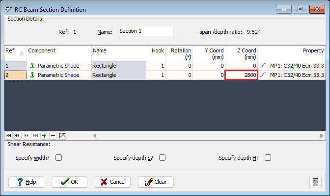

Again click the table insert + button and select “Parametric shapes” from the list. Using the Define Reinforced Concrete Beam Component form, create a “Rectangle” of 550mm width and 350mm height. Click on the ✓ OK button to close the Define Reinforced Concrete Beam Component form.
On the second row of the table, enter a value of “2800mm” in the Z Coord field and press 'Enter'. Click on the
button in the graphics window toolbar.
Following join:

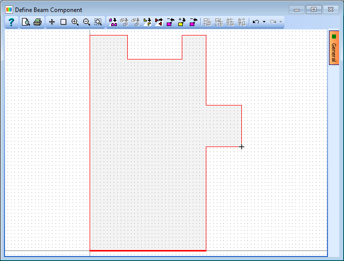

Click the table insert + button and select “Parametric shapes” from the list. Using the Define Reinforced Concrete Beam Component form, create a “Rectangle” of 350mm width and 350mm height. Click on the ✓ OK button to close the Define Reinforced Concrete Beam Component form.
On the second row of the table, change the Y Coord value to “1350mm” and the Z Coord value to “2800mm” and press 'Enter'. Click on the

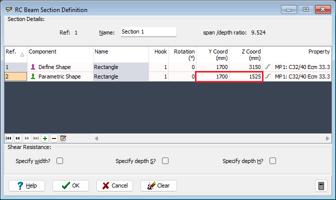

Create another “Rectangle” of 515mm width and 600mm height using the same method as step 7. Change the Y Coord value to “1700mm” and the Z Coord value to “1525mm” and press the 'Enter' key. Click on the
Click on the bottom face of the section in the graphics window. The face will change to a dashed line. This line type is used to indicate a continuous face. Click on the bottom face again to change it to a solid, bold line. This defines the line as a soffit face to follow the soffit profile of the beam.

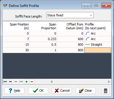

Define Soffit Profile
Click on the Define drop down menu and select “Soffit Profile” from the list. This will open the Define Soffit Profile form.
- Insert 2 more rows using the table + button.
- On the second row of the table, click in the Span Position field and enter a value of “7.0m”. On the same row, click in the Offset from Datum field and enter a value of “600mm”.
- On the third row, enter a value of “15.00m” in the Position along span field and enter “800mm” in the Offset from datum field.
- On the fourth row enter “800mm” in the Offset from Datum field. On the first row, click in the Profile (to next point) drop down and select “Arc” from the list.
- Click on the ✓ OK button to close the Define Soffit Profile form.

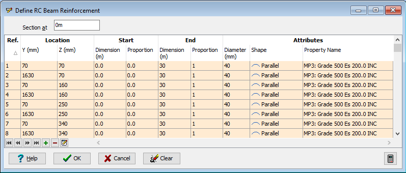

Click on the Define drop down menu and select “Reinforcement” from the list. This will open the Define RC Beam Reinforcement form together with two graphics views, one showing the elevation and one the cross section of the beam.

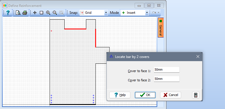

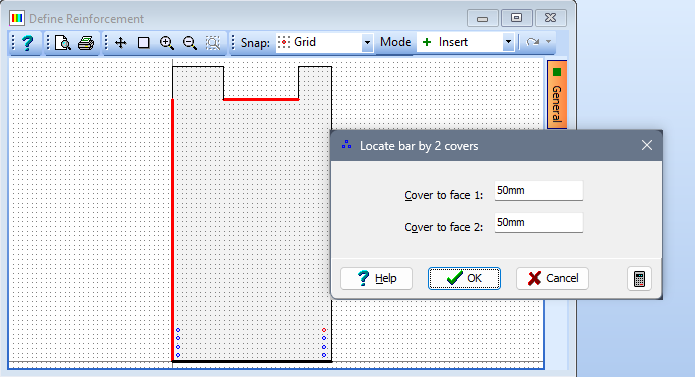

Click and hold the green arrow marker in the graphics window and drag it to the support at the left hand end of the beam. Click on the + button near the bottom of the form to open the Define Reinforcement form. The outermost bars in each row of reinforcement will first be defined with appropriate cover.
Click on the Generate drop down and select “1 bar by 2 covers”.

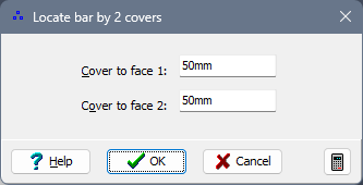

Set the Diameter field to “40mm” then click on the bottom and left hand faces of the cross section. This opens the Locate bar by 2 covers form. Leave both covers set to “50mm” and click ✓ OK. Repeat the process, this time clicking on the bottom and the right faces and use the same cover.
- Next click on the bottom and left hand faces and enter covers of “50mm” and “140mm”. Repeat this using the bottom and right hand faces, entering covers of “140mm” and “50mm”.
- Repeat these steps, entering covers of “50mm” and “230mm”, and “230mm” and “50mm”. Finally repeat these steps, entering covers of “50mm” and “320mm, and “320mm” and “50mm”.

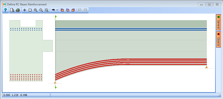

The program assumes reinforcing bars are horizontal. The side elevation will look like this:

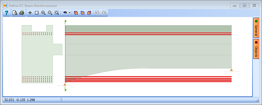

It is required that the bottom bars should run parallel with the soffit. To do this, draw a box around all the bottom bars in the cross section and click on the Edit reinforcement attributes button
at the bottom of the form. Click on the “Set Bar Shape” button on the form that appears. This opens the Reinforcing Bar Shape form.
Click on the Shape drop down and select “Parallel to soffit”. The elevation will automatically update to show the reinforcement in the correct location. Click ✓ OK to close the Reinforcing Bar Shape and Edit Reinforcement Attributes form.

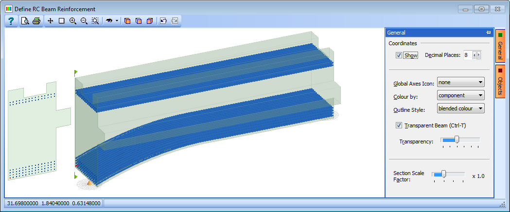

Clicking on the
icon when the Define RC Beam Reinforcement form is open shows an isometric view in which a three dimensional representation of the reinforcement can be seen. Parameters for this view can be controlled on the orange General tab at the side of the graphics window.
