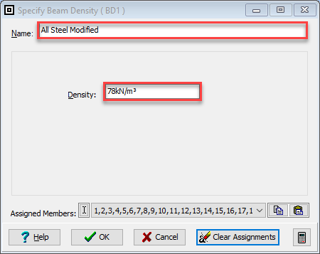

at the top of the navigation window and select Advanced Beam Assignments | Modified Density from the dropdown list.Change Name: to be “All Steel Modified” and the Density: to “78”.
Now window round the whole structure in the graphics window to select all the members.
Close the Specify Beam Density form with the ✓ OK button.

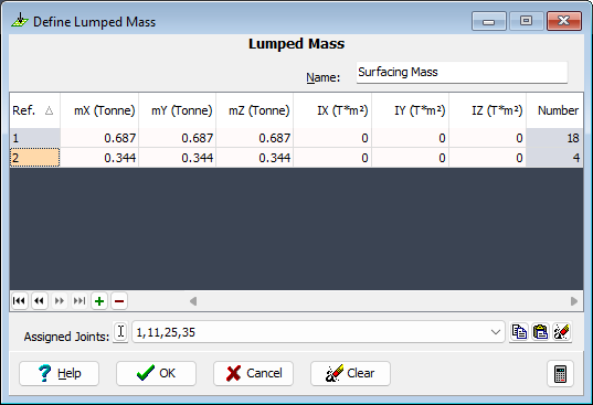

Surfacing Mass
The surfacing mass of 0.7 kN/m² is to be added as Lumped mass on the nodes of the bottom boom. The deck is 55m long and 3.5 m wide so the added weight is 134.75kN. This will be applied to the 22 nodes in the deck, with the two end nodes at each end having half the mass of the others. This works out to 6.74kN (0.687Tonnes) on internal nodes and 3.37kN (0.344Tonnes) on the end nodes.
Change the navigation window to Structure Loads and click on
in the toolbar and select Lumped Mass from the dropdown list.Add 2 rows of data using the table + button.

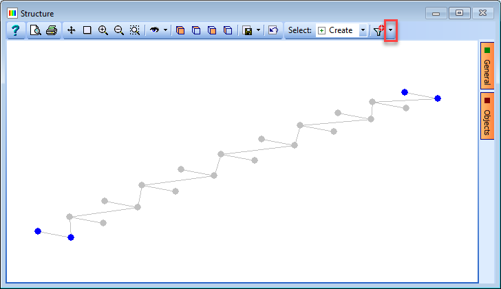

In the first row set mX mY and mZ to be all “0.687” and then click on each of the 18 inner nodes in the deck. (This may be easier to see by filtering in the “Bottom Bracing Deck” sub-model).
In the second row set mX mY and mZ to be all “0.344” and then click on each of the 4 end nodes in the deck. (Don't forget to remove the filter if you applied it in the step before).
Change Name: to be “Surfacing Mass” and then close the form with the ✓ OK button.

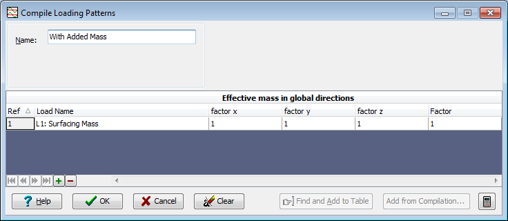

To enable the addition of this into the structural mass we need to create a dynamic compilation with this mass in it. Change the navigation window to Structure Compilations.
Click on
at the top of the navigation window and select Dynamic from the dropdown list.Add a new row using the table + button. In the new row select the Load Name as “Surfacing Mass”. The default value for the Factor is 1.0 which is correct.
Change the Name to “With Added Mass” before closing the form with the ✓ OK button.

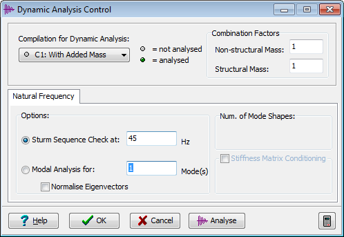

In the main menu select Calculate | Dynamic Analysis... to open the Dynamic Analysis Control form.
Set the Compilation for Dynamic Analysis: data field to “C1: With Added Mass”.
The first analysis is a Sturm Sequence Check which checks the number of modes below a given frequency. Check that this option is selected on the data form and enter a frequency of “45”.

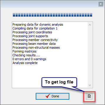

Click on the Analyse button. Click OK on a warning message that may appear.

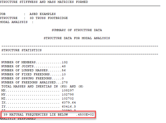

When the analysis is complete click on the “Log File” icon at the bottom righthand corner of the Analysis form to open up the log file. This should report that there are 39 modes below 45 Hz.
Close the Analysis Log File with the green EXIT button and the Analysis form with the ✓ Done button.
On the Dynamics Analysis Control form (which should still be open) select the Modal Analysis for: radio button and set the data field to 39 Modes.
Click on the Analyse button. (The software may take a few seconds to perform the analysis).
When the analysis is complete, close the analysis form with ✓ Done and close the Dynamic Analysis Control form with the ✓ OK button.

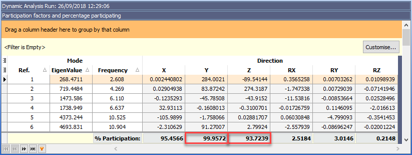

In the dark blue Results Control area tick the Show Participation Factors tick box to display the following table.
The percentage mass participation (at the bottom of the table) shows 93.7% vertically and almost 100% laterally.
On inspection of the displacement participation factors for each of the first few modes, it is clear that the first vertical deflection mode is mode 2 and the first lateral deflection mode is mode 1.

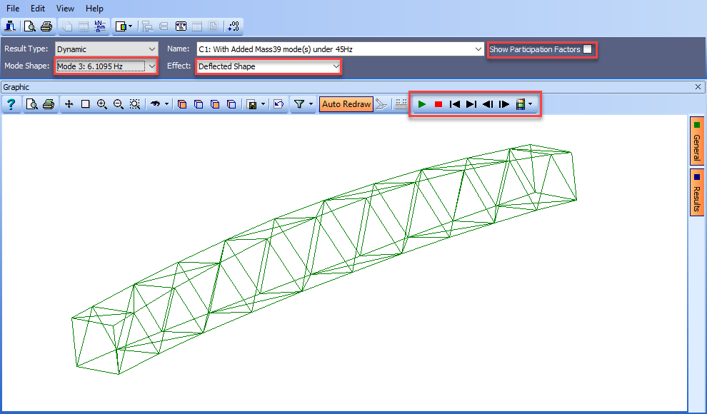

These mode shapes can be visually checked by un-ticking the Show Participation Factors tick box, setting Effect to “Deflected Shape” and clicking on the “Auto Redraw” button on the graphics toolbar. Each mode can then be selected in the Mode Shape data field and the mode shape will be displayed.
It may be easier to interpret the shapes if they are viewed in animation by using the controls in the graphics toolbar. It is clear that mode 3 is the first twisting mode.
