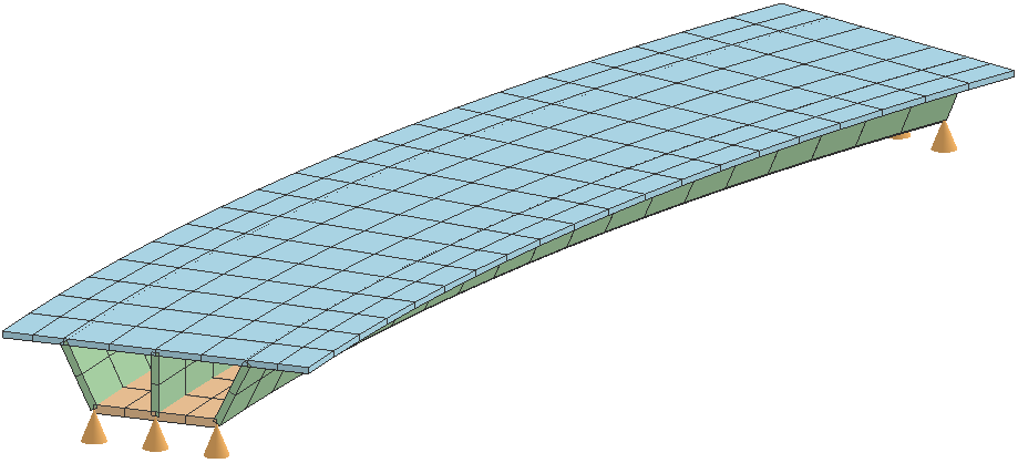

The box girder bridge below has a slab thickness of 200mm and a bottom flange thickness of 275mm. The thickness of the webs is 250mm. The structure is modelled using 3D shell finite elements. The geometry of the structure is complicated with the slab (curved on plan) and sloping webs of the box girders. A structure with such geometry would be difficult to define directly in Autodesk Structural Bridge Design. However, such geometry is relatively easy to define in Autodesk® AutoCAD. Hence, a DXF file has been prepared in AutoCAD using a set of specialised commands which are loaded into AutoCAD. The DXF file will be imported into Autodesk Structural Bridge Design to define the geometry of the structure.

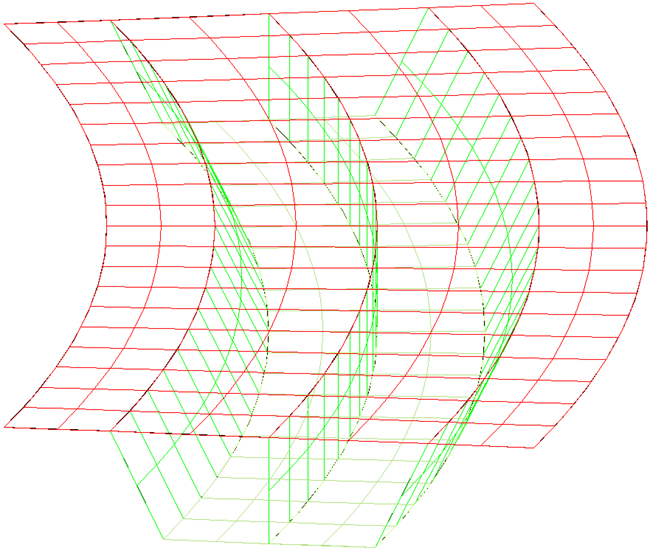

- Draw 3D lines and arcs in layer “0” to represent the boundary of the deck.
- Set the system variables Surftab1 and Surftab2 to define the mesh density and then use Edgesurf to create a mesh by clicking on the 4 edges of the boundary line starting with the bottom edge and working around the edge of the structure in an anti-clockwise direction. This divides the deck along the lines that define the mesh.
- Define a new drawing layer (Colour eg Red) and name it say, “DECK".
- Make the DECK layer the current layer end then “Explode” the mesh which will create 3DFaces in the DECK layer.
- Repeat a similar process for the Bottom Flange in a different layer with a different name and colour.
- Create boundary lines between the two layers and follow a similar process to create 3 meshes representing the 3 webs and explode them into a new layer, named say “WEBS”.

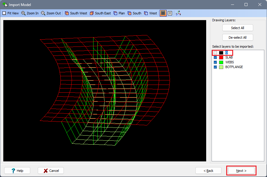

With the "Refined Model" node selected in the Structure Definition navigation window, click on the Import Model
icon in the toolbar to open the Import Model form.Select the “Bridge Structure” radio button. This will ensure that all members in the Z=0.0 plane are automatically assigned as deck members when the data is imported into the program.
Click on the Browse button and open the supplied DXF file with a name of "BoxGirder.dxf".
Click on the Next button to move to the next form.
Untick the tick box for base layer "0". The tick boxes for all other layers are ticked.
Ensure that the One linear drawing unit... field is set to “metre” and click on the Next button to move to the next form.
When the data has been imported click ✓ OK to close the Import Model form.

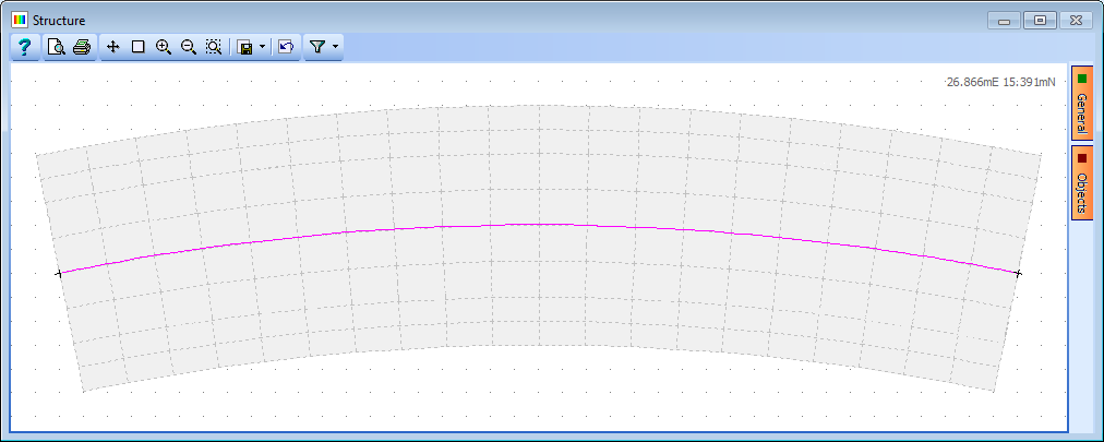

We will define a design line which will be used to align the carriageway.
Select the Refined Model node in the navigation window and click on the
button to select “Design line” to open the Define Design Line form.Click the + button at the bottom of the data form and in the resulting form select the Arc radio button and click the Next> button.
Select the 3 points on curve radio button and click the Next> button.
Set the Snap field at the top of the graphics window to “Intersection” and select 3 points along the centre of the deck in the graphics window by clicking on the point at the left hand end of the deck, a point near the centre of the span and then at the right hand end of the deck.
Click Next> and ✓ OK to close all the forms.

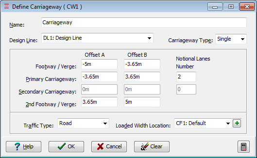

Next we will define the carriageway that will run over the structure.
Click on the + button and select “Carriageway” from the dropdown menu to open the Define Carriageway form and set the fields to the selections and values shown below.
(Note that the traffic flow direction is indicated by a triangular arrow head in each notional lane and clicking on each of the arrows until they are double-headed will show that traffic can flow in either direction. However, in this example we will leave the lanes as single direction).
Click ✓ OK to close the Define Carriageway form.

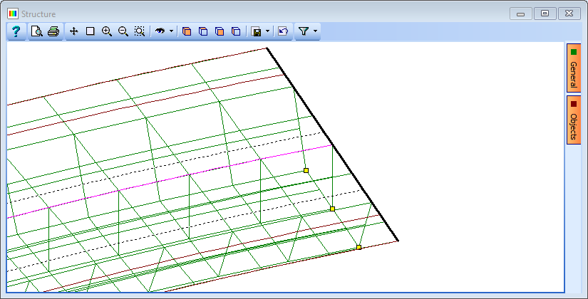

toolbar button to select “Span End Lines”. This will open the Define Span End Lines form.Click on the bottom left and top left-hand corners of the structure on the graphics window. This will draw a heavy black line.
Repeat this for the right-hand abutment to define the span end lines.
Click ✓ OK to close the form.

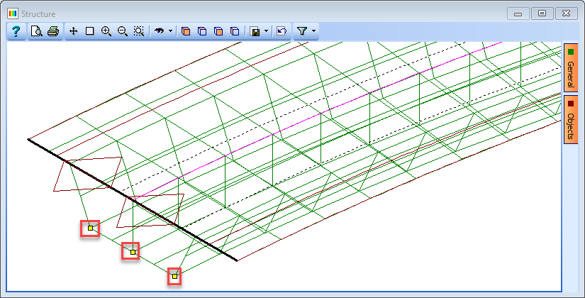

Click on the Refined Model node in the navigation window and then click on the

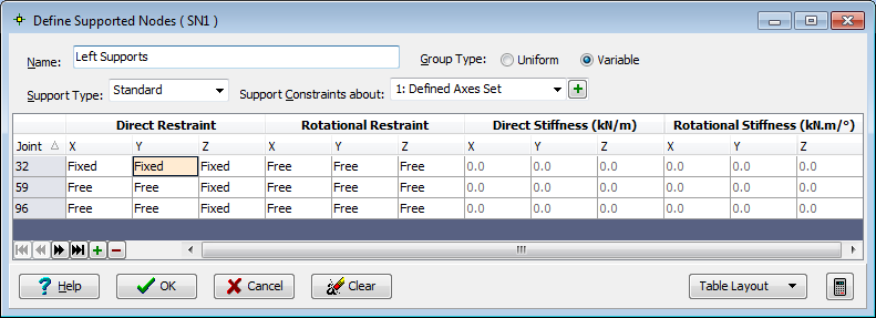

button to select “Supported Nodes”.Ensure that the Select: field is set to “All Joints” and select the 3 nodes at the left hand end of the structure as shown below.
In the first row of the support table, change the support conditions so that only the DZ direction is fixed. Change Group Type to “Variable” then click on the middle of the 3 nodes (node 32).
Change the support conditions for this node so that it is also fixed in DX and DY.

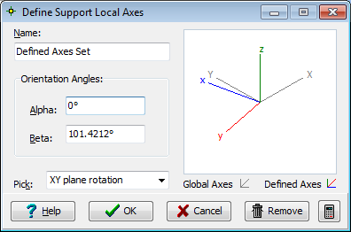

The orientation of the supports will be altered such that the local y axis is tangential and the local x axis is radial.
Click on the + button next to the Support Constraints about field to open the Define Support Local Axes sub-form.
Click on the bottom right support node (node 59) then on the bottom left support node (node 96). Note that the angle in the Beta field has changed to 101.4212 degrees.
Click ✓ OK to close the sub-form.
Change Name to “Left Supports” and click ✓ OK to close the Define Supported Nodes form.

Click on the

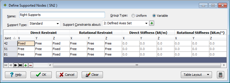

button and select “Supported Nodes” again.Select the 3 nodes at the right hand end of the structure as shown below.
Change Group Type to “Variable” then click on the middle of the 3 nodes (node 42).
Change the support conditions for this node so that it is also fixed in DX.

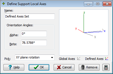

Click on the bottom left support node (node 51) then on the bottom right support node (node 81). Note that the angle in the Beta field has changed to 78.5788 degrees.
Change Name to “Right Supports” and click ✓ OK to close the Define Supported Nodes form.
