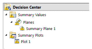

The Decision Center should list the Summary Plane and the Summary Plot. Both will have the "warning" icon. This means that the Summary Values must be updated before we can assess results:
decision center dialog

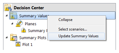

In the Decision Center, right click on Summary Values, and click Update summary values.
decision center update

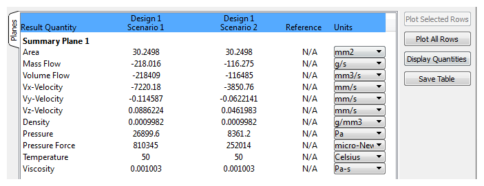

You can compare the pressure drop in the two scenarios, on the Planes tab:
planes tab

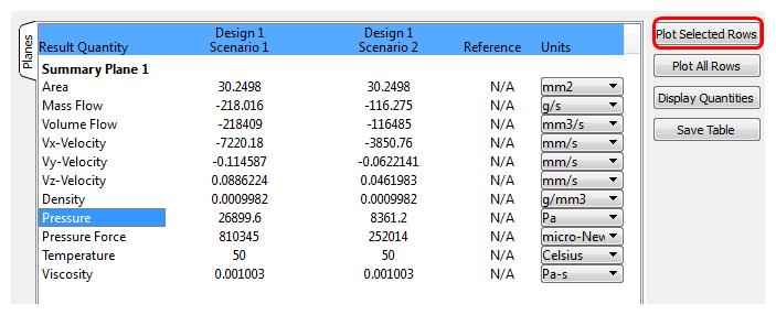

To plot the pressure, click on Pressure, and click Plot Selected Rows.
plot rows

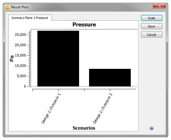

rows plot
