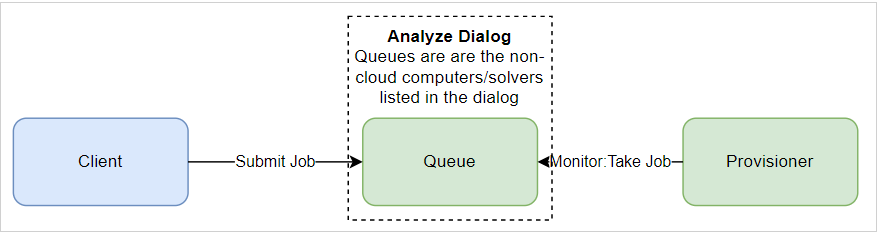

Local Solve
The Client, SCM queue, and Solver in below scenario are ALL on the local machine.

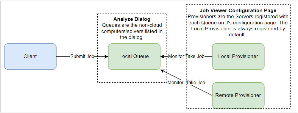

Network Solve
The Client, Local SCM Queue, and Local Solver in below scenario are ALL on the local machine. The Remote Solver is running on an entirely different machine, connected by the local network, and is registered with the Local SCM Queue. Both Solvers are monitoring the SCM queue for jobs to take. If both solvers can solve the job in the local SCM queue ,the first one to see it will take it. This is a first come, first serve process and no priority may be given to one solver over another.

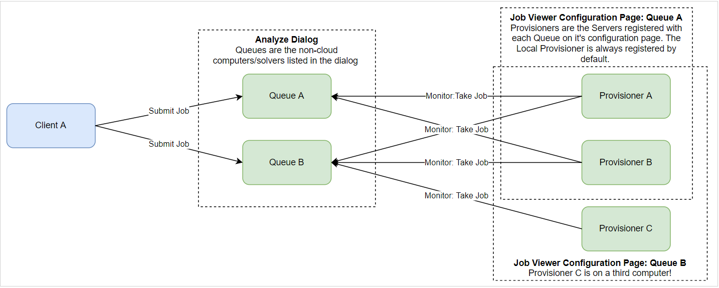

In the scenario shown there are three computers on the local network involved. In this advanced section we will use the technical terms for all the components involved. The log files and advanced configuration options all reference these names. In this case the components are:
  • Client: The UI were the job is submitted from.
  • Queue: An SCM Queue running as part of the SCM service on a computer.
  • Provisioner: The SCM process running on a computer that is responsible for monitoring the Queues it is registered with. It is aware of the solvers that are installed and registered with SCM on the compter it is running on.
  • Computer A is the the computer the job is submitted FROM. It has the following running on it.
    • Client A
    • Queue A
    • Provisioner A
  • Computer B is another computer on the network. It has the following running on it.
    • Client B
    • Provisioner B
  • Computer C is yet another computer on the network and has the following running on it (for the purposes of this example*).
    • Provisioner C
Important points to note:
  • The Analyze Dialog on Client A has it's own Queue A available, as well as remote computer Queue B available.
  • Queue A has both Provisioner A and the Provisioner from Computer B registered to it. Either can take a job submitted to Queue A.
  • Queue B has both Provisioner B and the Provisioner from Computer A registered to it. It also has another Provisioner from computer C registered with it. Any of these three Provisioners can take a job submitted to Queue B.
  • It is important to note that a Job submitted from Client A to the Queue on Computer B could be picked up by the Provisioner on Computer A, and solved on Computer A. Yes, this is a circle and it is ok.
  • There is NO preference given to any Provisioner. The first one to see a Job on a Queue it is monitoring that it can handle will take it.
  • Hostnames are preferred to IP addresses when adding a computer to the distributed solve network. The identifier used must be accesible both publically and privately from any computer in the network. This is typical of a LAN scenario, but may not be the case in a Wide Area Network (WAN) or certain LAN configurations. SCM requires this to properly orchestrate jobs within the distributed solve network.
