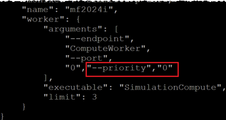

  5. Edit the JSON file by adding the keyword –priority and the corresponding value for the different level of priority in the solver section.
    config-linux-file
    • The value "0" corresponds to Below Normal priority.
    • The value "1" corresponds to Normal priority. This is the default value.
    • The value "2" corresponds to Above Normal priority.

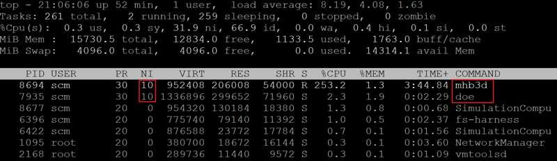

  10. Type top to open the list of processes running in Linux.
  11. Check the Nice valuefor the solver job running in the list of process.
  • The value "10" corresponds to Below Normal priority. This is the default value.
  • The value "0" corresponds to Normal priority.
  • The value "-10" corresponds to Above Normal priority.
