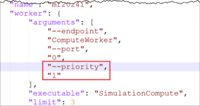

  1. Modify the file ComputeProvisioner.config.json with Notepad++ or equivalent. The file location is
    C:\ProgramData\Autodesk\SimulationCompute\v<version number>\config\
    Note: You will need Administrator rights
  2. Add the keyword –priority and the corresponding value for the different level of priority in the solver section of the JSON file.
    config-file
    • The value "0" corresponds to Below Normal priority.
    • The value "1" corresponds to Normal priority. This is the default value.
    • The value "2" corresponds to Above Normal priority.

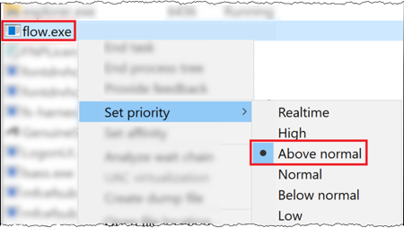

  7. Open Task Manager, click Details tab.
  8. Select the solver process, then click Select priority and verify the priority level.
