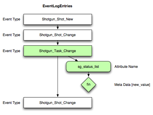

Below is a simple diagram of EventLogEntries generated by Flow Production Tracking. Your Script will use the API to get a list of events that have occurred since the last time it asked. It will then look at each event type (e.g., Flow Production Tracking_Task_Change) and see if any of them are ones that you care about.
Once it finds an event that is interesting, it will examine the details of the event even further (e.g., what field was changed, what the value was changed to, etc. At this point you can even use the API to request more information for an entity if you need to).
If the event proves worthy, the Script will then act on the event and execute whatever code you decide needs to be executed whether its using the Flow Production Tracking API, or something in your pipeline, or both. When there are no more events to look at, it repeats the process and use the API to get a list of events that have occurred since the last time you asked.
