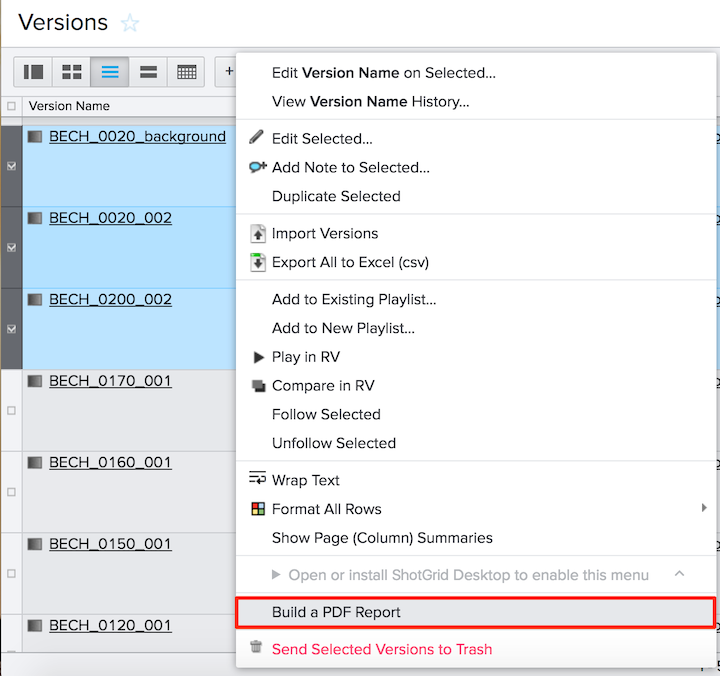

API developers can customize context menu items on a per-entity basis, through Action Menu Items (AMIs). For example, from a Versions page, you could select multiple versions, right-click, then choose “Build a PDF Report.”

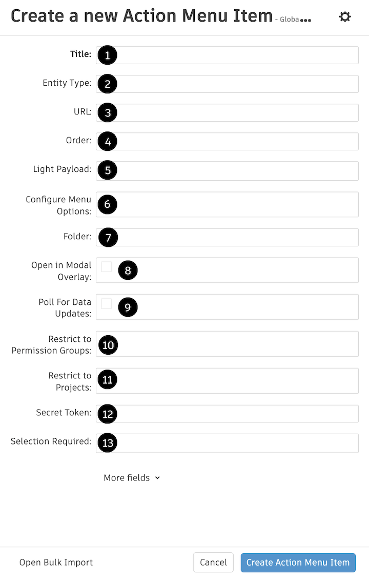

Action Menu Item fields
1. Title (title): The display name of the menu item.
2. Entity Type (entity_type): Restrict the menu item to only appear on one type of entity page, such as Version. Omitting this key (a nil value) has the effect of allowing the menu item on ALL enabled entities.
3. URL (url): The URL of our script that will create the PDF report.
4. Order (list_order): The ordinal position of the menu item (relative to other custom menu items).
5. Light Payload (light_payload): When using a custom protocol your script will receive the id of the event log entry record that holds the payload information instead of the full payload itself.
6. Configure Menu Options: There are a few options to select from:

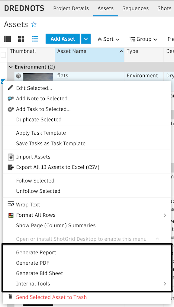

Include in the right-click menu on an Entity record: This is the default value that will include the AMI by right-clicking on a record.

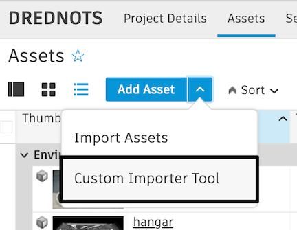

Include in "Add Entity" dropdown menu on Entity pages: Option to include this AMI in the "Add Entity" dropdown menu (ex: "Add Asset", "Add Shot", etc.).

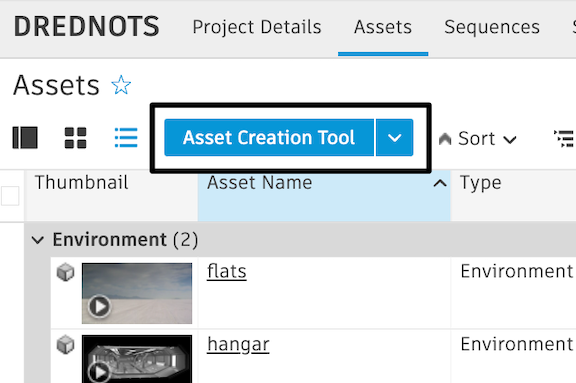

Override "Add Entity" button on Entity pages: This option allows you to overwrite the "Add Entity" button with an AMI.
Include in Internal Resources section of the User Menu: This gives you the option to customize the User Menu with internal resources. Learn more about customizing the user menu with internal resources here.

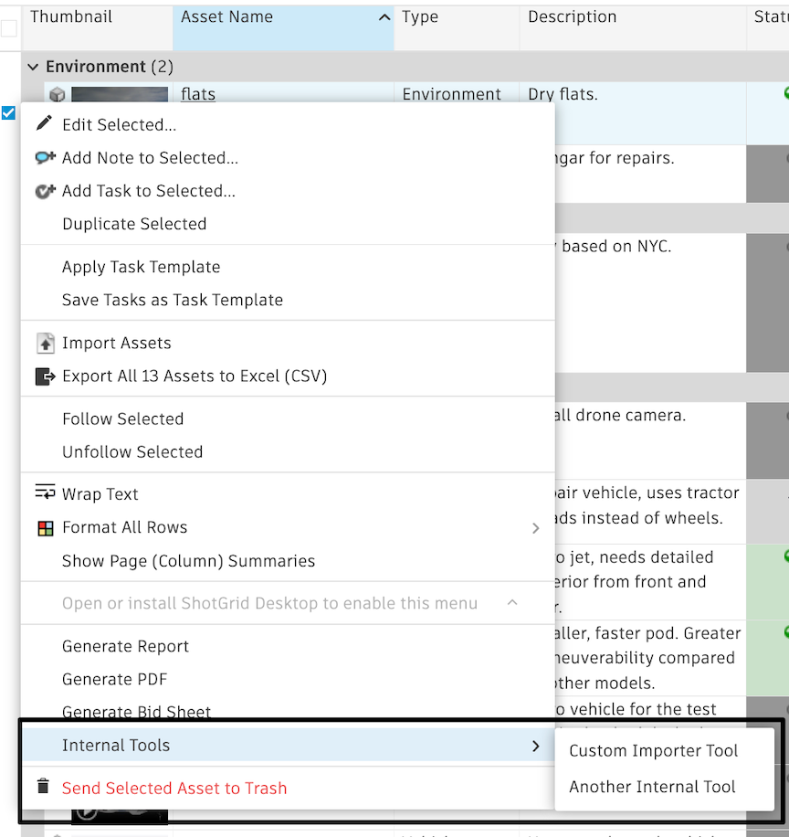

7. Folder (folder): Allows you to organize AMIs into folders within the context menu (currently only a single level of folders is supported).
8. Open in Modal Overlay: Allows AMIs to open in an iframe window, instead of in a new tab. Please note that if Shotgun is running HTTPS, then all iframes need to be HTTPS as well.
9. Poll for Data Updates (poll_for_data_updates): Starts a polling loop to query for event log entries. This is for cases where the code on the other end of the ActionMenuItem makes changes back to Shotgun via the API on entities that are visible on the page that triggered the ActionMenuItem.
10. Restrict to Permission Groups (permissions_groups): Allows you to restrict access for the AMI to only specified permission groups. If left empty, AMI will be available for all users.
11. Restrict to Projects (projects): Will make it so the AMI only shows up in specified Projects. If left empty, AMI will be available in all Projects.
12. Secret Token: Secure your AMI by setting a secret token.
13. Selection Required (selection_required): Determines whether the menu item will be active if there are no rows currently selected.

As an example, you can create a custom menu item called “Build PDF Report.” This will allow people to go to any Versions page, select one or more Versions, right-click, and then choose “Build PDF Report” from the Flow Production Tracking menu. Doing this will launch a script, which you must create, to get a nicely formatted report sent back to their browser. Here's how it works:
Create the menu item via the UI

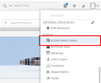

From the settings menu, choose Action Menu Items to open the AMI Admin page.
To create a new AMI, click on .
Fill out the Title and any other required fields, and click on “Create Action Menu Item.”
What happens when a user clicks on the AMI?
Flow Production Tracking dispatches a POST request in a new window, or in a modal dialog if that option was selected, and sends along data from the current page (as part of the POST request) to the receiving URL. Here's an example of the workflow.
- User navigates to a Versions page
- User selects one or more Versions
- User brings up the context menu (by right-clicking or clicking on the gear menu in the toolbar)
- User clicks ‘Build PDF Report’
- Flow Production Tracking dispatches a POST request to the AMI’s URL in a new window (If your Flow Production Tracking server is served over HTTPS, and your URL is served over HTTP, expect to see a browser warning)
- Your script, located at the URL specified, processes the POST data, and generates a PDF document
- A nicely formatted PDF report is sent back to the user for viewing or download
