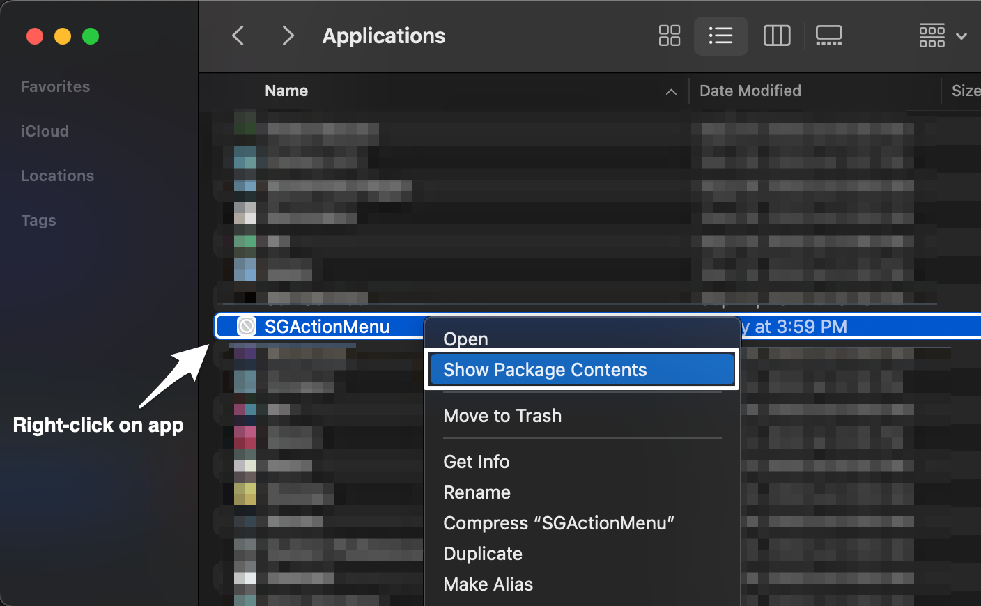

Step 2: Edit the info.plist file
Find the saved Application Bundle, and Open Contents.
Locate App
Then, open the info.plist file and add the following to the plist dict:
Open info.plist file
