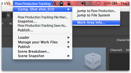

This app gives a graphical breakdown of the current work area and all the apps running in the current environment. You can find it on the Context Menu:

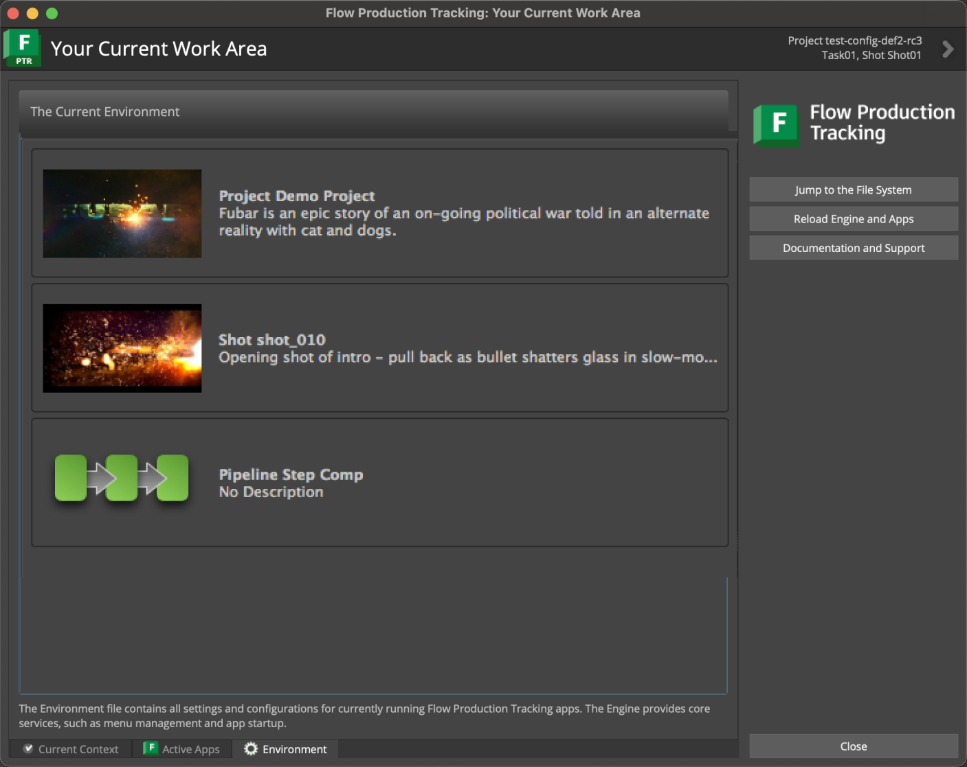

Current Work Area
This shows the current Shot or Asset, the current Task etc. If you double click any of the items in the list, the system will open the Flow Production Tracking Detail page for that item.

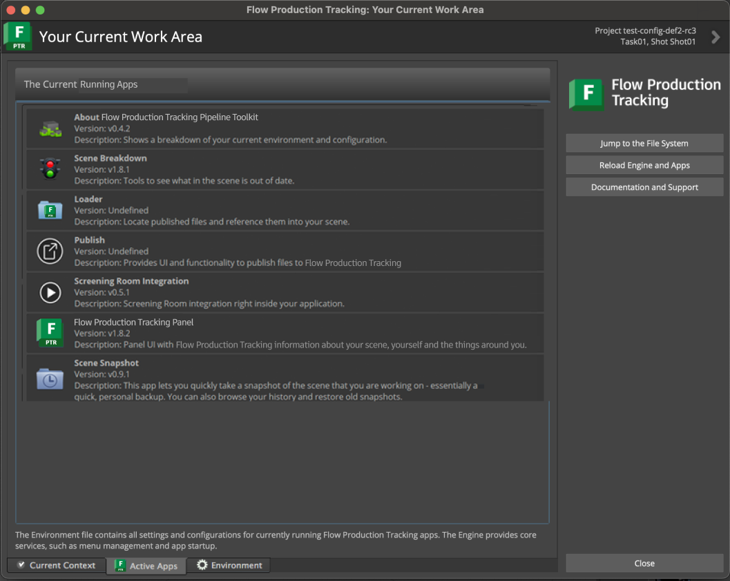

Running Apps
A view of all the currently running apps, along with their version and description. Double clicking an app will launch the documentation page for that app.

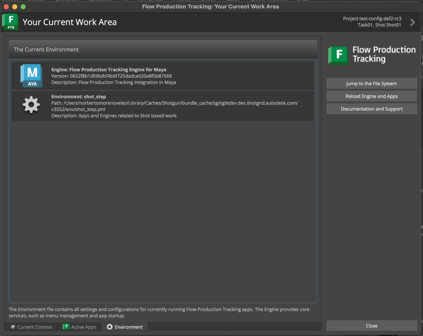

Current Environment
A view of the currently loaded environment file and engine. This can be useful for debugging purposes.
