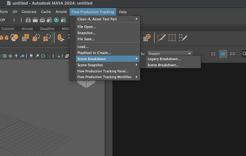

Both the Breakdown and Legacy Breakdown apps are available in your application via the Flow Production Tracking menu > Scene Breakdown.
Accessing the breakdown app
Note:
You can run both the Breakdown and Legacy Breakdown apps concurrently, as seen in the above image. Running both apps at the same time is the default behavior.

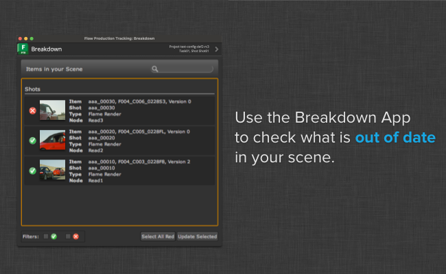

The Legacy Scene Breakdown app shows you a list of referenced content and tells you which items are out of date. You access it from the Flow Production Tracking Menu.
Overview of the legacy breakdown
You can select one more items and hit update selected. This will switch the items to use the latest version of the content.
