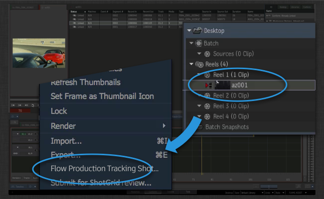

Once you have your conform set up in Flame for a sequence, and have allocated shot names to all the segments in your timeline, select the sequence, right click and choose the Flow Production Tracking Shot Export option.
menu

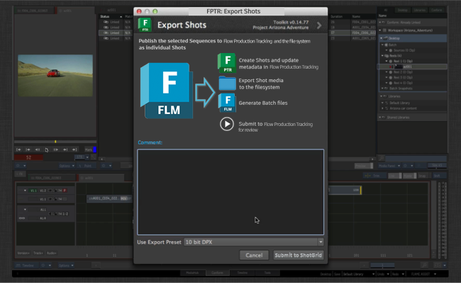

This will bring up a Flow Production Tracking UI where you can enter some initial comments for your publish. These comments will be sent to review and also used when adding description to publishes and other content.
In addition to the description, you can also select which output data format you want to use for your exported plates. These presets are part of the toolkit app configuration and can be configured to suit the needs of your studio.
shot_export
Once you click the submit button, a number of things will happen straight away:
  • Shots and Tasks will be created in Flow Production Tracking. The list of tasks to associate with each new Shot that gets created is configurable via a Task template setting to make it quick and painless to create consistent structures. The shots will be parented under a sequence by default, but this is also configurable and if you are working with Scenes or Episodes, it is possible to reconfigure the exporter to work with these instead.
  • Once Flow Production Tracking contains the right data, folders will be created on disk using the standard folder creation mechanism. This ensures that the project can be kick-started with a set of consistent folders for all shots that are being created.
Once the two steps above have been carried out, you have the basic structure to proceed with further steps. These will happen in the background:
  • Plates will be exported on disk for each shot according to the presets defined in your configuation. File locations are defined using the Toolkit Template system, meaning that the location of these plates will be well defined and understood by other tools downstream in the pipeline.
  • Batch files and clip xml files will be exported. These are used by Flame to enable an iterative workflow where you can quickly render out new versions that are later pulled in to the main conform in Flame.
  • Quicktimes are generated and uploaded to Flow Production Tracking for review.

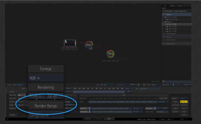

Once you have published a Flame batch file for a Shot, you can launch Flare directly from that Shot in order to open up the batch file with render and output settings pre-populated. In order to render out a new version, simply click the Render Range Button.
render_range

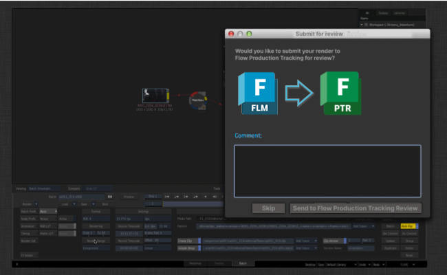

Toolkit will display a dialog at this point where you can choose to send the render to Flow Production Tracking review or not.
flaver_review
Files will be published and tracked by Flow Production Tracking and optionally also sent to review.
