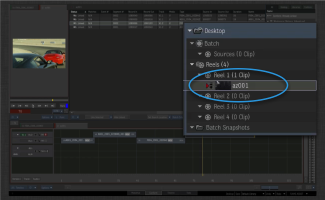

Simply right click a sequence or a selection of sequences that you want to review:
menu

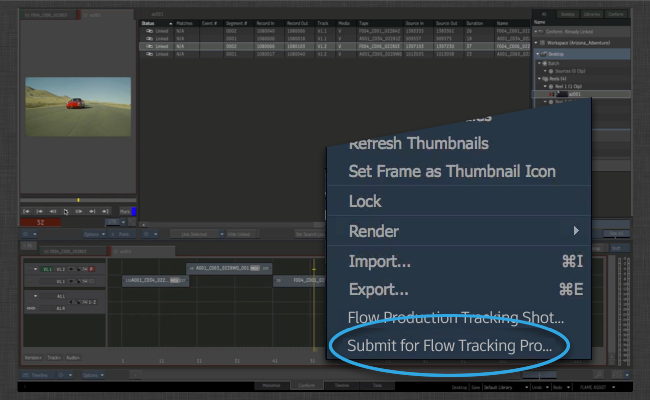

Select the Flow Production Tracking Review Option:
select

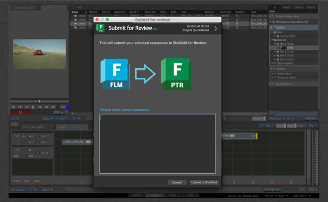

A Toolkit UI will appear where you can add some review notes:
UI
When you click ok, a background job will be generated and everything will happen behind the scenes. The following steps will be carried out:
