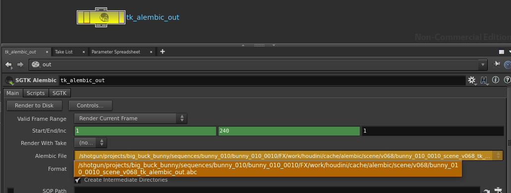

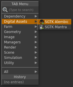

In order to use the Flow Production Tracking Alembic Output, save your script as a Toolkit work file first and then create a new node via the TAB menu in Houdini. This will create a node which looks similar to a normal Alembic output node:

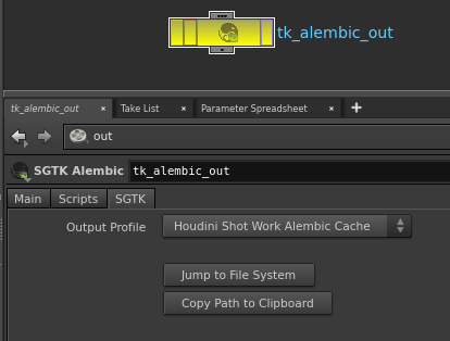

The node can be configured with multiple output profiles, each using a different template path for where the alembic cache should be written to disk.
Rather than entering a path by hand, you just specify which output profile to use and the node will compute the rest of the path automatically. You can see the computed path in the UI.
The output alembic files will be versioned and the version number will always follow the current Houdini scene file version which will be incremented automatically when you publish using Multi Publish.

You can use the output profiles to alter the look of the node via the color field, and you can adjust individual parms on the underlying Alembic node by supplying key/value pairs matching those parms in the settings field. Finally, the output_cache_template field drives the output path for the alembic cache written to disk.
