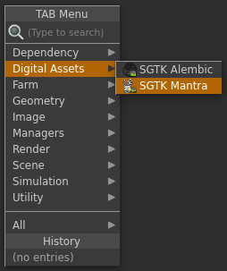

In order to use the Flow Production Tracking Mantra Node, save your script as a Toolkit work file first and then create a new node via the TAB menu in Houdini. This will create a node which looks similar to a normal Mantra output node:

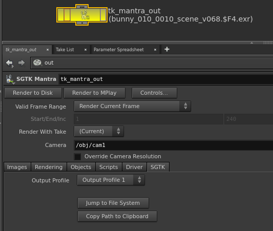

The node can be configured with multiple output profiles, each using a different set of template paths for where the render output (images, ifd, dcm, aov, etc) should be written to disk.
Mantra Node

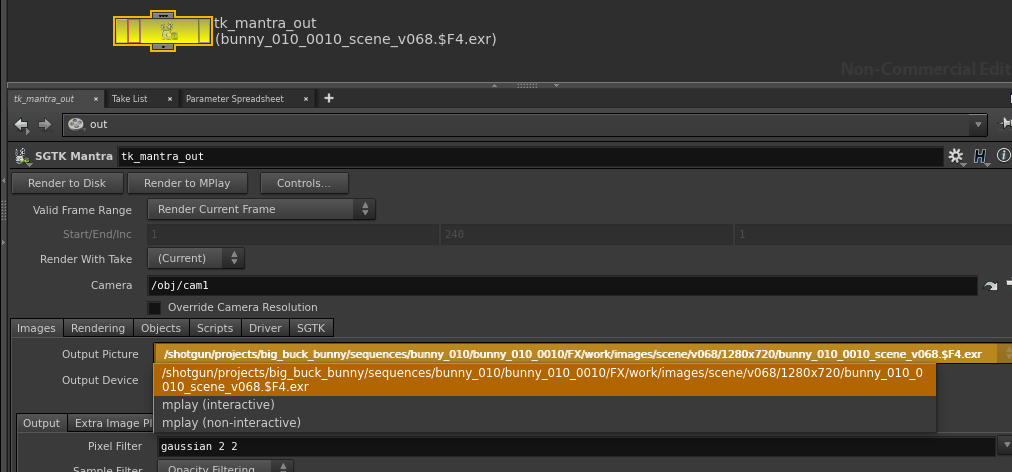

Rather than entering a path by hand, you just specify which configuration to use and the node will compute the rest of the path automatically. You can see the computed path in the UI.
Mantra Node
The rendered files will be versioned and the version number will always follow the current Houdini scene file version which will be incremented automatically when you publish using Multi Publish.
