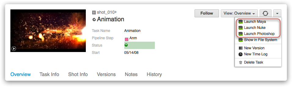

Depending on your configuration options a menu entry will appear in Flow Production Tracking when right-clicking entities or using the Flow Production Tracking actions menu or gear menu.
For example, this screenshot comes from a site who's configuration uses this app three times to implement menus for Maya, Nuke and Photoshop.
