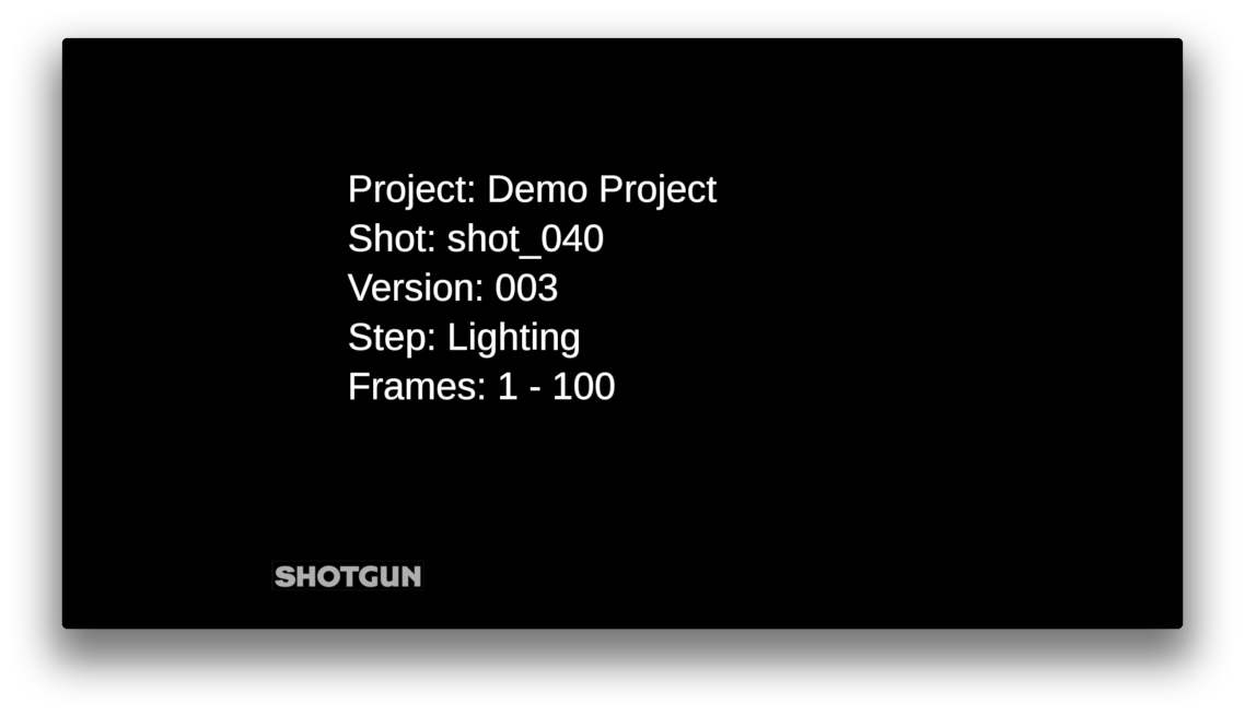

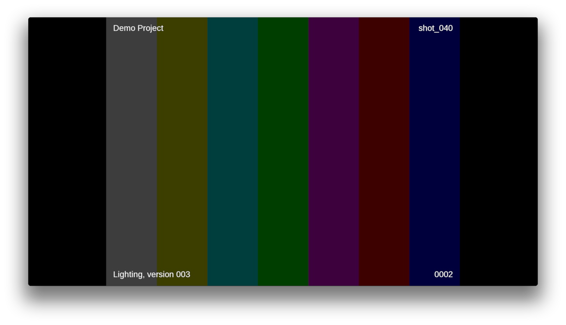

Here are a the current default formats for slate and burnin:
