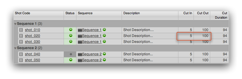

When you click it, the Flow Production Tracking Toolkit will look at the Flow Production Tracking entity associated with the current work area (typically a Shot) and look for in and out fields which contain the in and out frame information. Typically, this is something used in conjunction with Shots and in that case the app uses the standard shot in and out fields defined in Flow Production Tracking's default config. However, it is perfectly possible to configure the app to pull the frame ranges from other fields too.

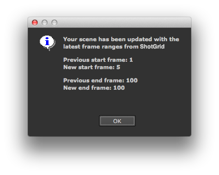

Once you run the App, it will update the current scene with those ins and outs and finally display a summary message:

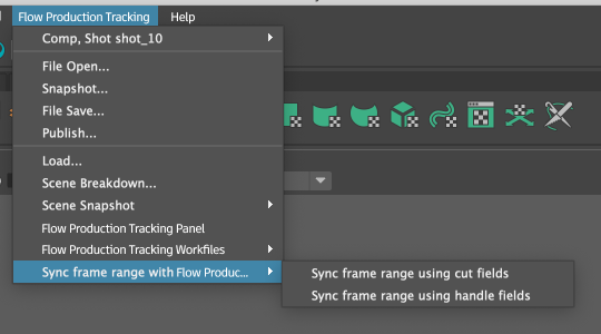

Multiple Flow Production Tracking field synchronisation options
You can define multiple instances of this app in the Flow Production Tracking Menu by setting the menu_name property. This allows the possibility to define a multiple menu actions for synchronization of different Flow Production Tracking fields.
To do this, set a different app instance name, menu_name and in and out frame fields for each instance:
tk-multi-setframerange_cuts:
  menu_name: Sync frame range using cut fields
  sg_in_frame_field: sg_cut_in
  sg_out_frame_field: sg_cut_out
  location: "@apps.tk-multi-setframerange.location"
tk-multi-setframerange_handles:
  menu_name: Sync frame range using handle fields
  sg_in_frame_field: sg_handle_in
  sg_out_frame_field: sg_handle_out
These should then appear as separate options in the Flow Production Tracking menu:
