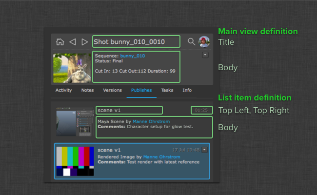

Controlling items appearing in lists
The get_list_item_definition() method returns a dictionary that controls the appearance of items in the various listings, given a Flow Production Tracking entity type. It returns a dictionary with the keys top_left, top_right and body, for example:
 "top_left": "<big>{code}</big>",
 "top_right": "{updated_at}",
 "body": "By: {created_by}<br>Description: {description}"
Controlling the top detail area
The get_main_view_definition() method returns a dictionary with the keys title and body given a Flow Production Tracking entity type. These values controls the appearance of an object in the detail area, for example:
 "title": "{type} {code}",
