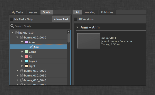

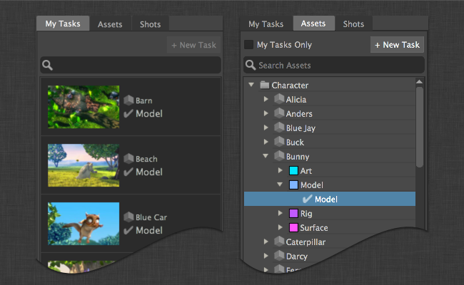

Navigating your work areas
The main dialog is split in two halves. On the left hand side, there is a series of tabs. The first tab is called "My Tasks" and will display all the tasks that are assigned to the current user. It is very reminiscent of the "My Tasks" page on the Flow Production Tracking website.
Alternatively, the user can also browse for a Flow Production Tracking entity using the entities tabs. By default, the workfiles application allows to browse for any tasks associated on shots or assets by looking at the respective tab.
The set of tabs is entirely configurable through the entities settings in the environment files.
You can disable/enable this dialog by setting the show_file_open: true/false in the app settings.
Finding files
On the right hand-side you will see the working files and publishes associated with the selection from the left hand-side. Working files and publishes can be viewed together or separately using the tabs "All", "Working" and "Publishes".

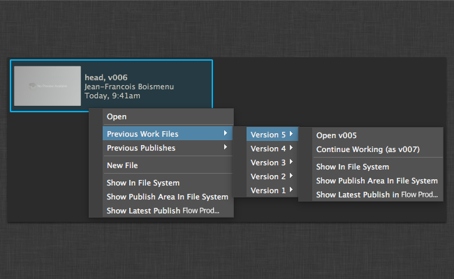

Accessing previous versions
There are two ways to access previous versions. First, the user can click on the "All versions" box at the top of the browser, which will uncollapse the versions and list them all individually in the browser. Another option is to right-click on a file, which will allow you to access the last 10 versions.

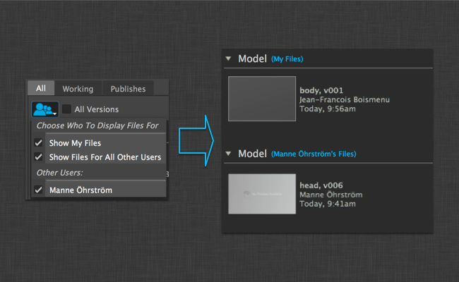

User sandboxes
If your pipeline configuration uses user sandboxes, only the files for the current user will be seen by default. If the user wants to see the files from other user's sandboxes, a button at the top will allow to pick which sandboxes to show files from.

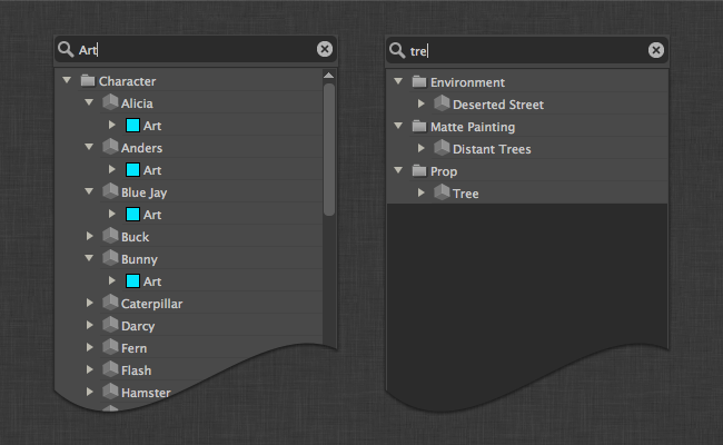

Narrowing results
You can narrow results in the any of the views by typing text. The search will match any item's name.

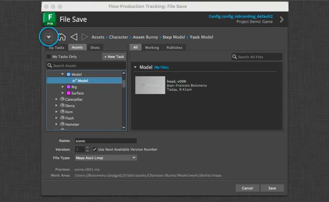

Saving in a different context
In order to save a file in a different context, a user can click on the expand button at the top-left of the dialog which will expand the "File Save" dialog and allow to pick another context to save into.

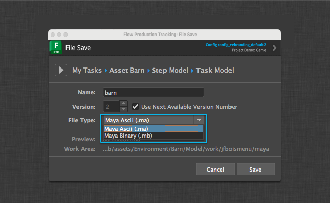

Adding the file extension dropdown
With the new file save dialog, it is possible to pick the extension of the file being saved. In order to enable this, you need to tweak your pipeline configuration's templates.yml file. First, a token needs to be defined in the token list inside templates.yml.
maya_extension:
type: str
choices:
ma: Maya Ascii (.ma)
mb: Maya Binary (.mb)
default: ma
alias: extension
maya_extension is the token's name. choices is a dictionary of file types that will be displayed in the dropdown. The keys (ma and mb) are the possible values that this template token can have. The values (Maya Ascii (.ma) and Maya Binary (.mb)) are UI friendly descriptions that can be used by a Toolkit application. The alias is an hint that is required by the workfiles application. It tells the application that this token is an extension and should be displayed in the dropdown widget.
Then, this token can be added to any Maya specific template.
maya_shot_work:
definition: '@shot_root/work/maya/{name}.v{version}.{maya_extension}'
root_name: 'primary'

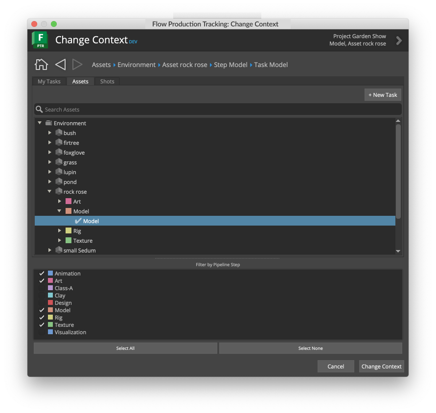

Context Change dialog
The context change dialog is similar to the open dialog except that it doesn't have a the right hand side for file browsing. You can select a task or entity and change your current engine context by pressing press the change context button.
You can disable/enable this dialog by setting the show_change_context: true/false in the app settings.

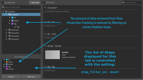

Step filtering
When retrieving Tasks, and if step is included in the hierarchy, the amount of data retrieved from Flow Production Tracking can be reduced with Pipeline Step filtering: only Tasks linked to the selected list of Steps will be retrieved.
The list of Steps displayed in a tab is controlled with the step_filter_on setting. If not set, all existing Pipeline Steps are displayed.
The example below defines two tabs, respectively displaying Tasks for Assets and Shots:
- caption: Assets Tasks
entity_type: Task
step_filter_on: Asset
filters:
- [entity, type_is, Asset]
hierarchy: [entity.Asset.sg_asset_type, entity, step, content]
- caption: Shots Tasks
entity_type: Task
step_filter_on: Shot
filters:
- [entity, type_is, Shot]
hierarchy: [entity.Shot.sg_sequence, entity, step, content]

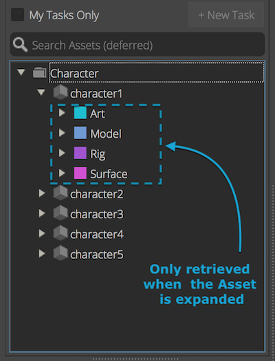

Deferred queries
For better performances, building the Entities tree can be broken into two step queries:
- A first query is used to retrieve records from Flow Production Tracking and populate the top of the tree.
- A second query is used to retrieve children as the user expand the tree.
With the following settings, Assets and Shots would be retrieved from Flow Production Tracking when the app is started. And then Tasks linked to a particular Asset or Shot would only be retrieved when this Asset or Shot is selected or expanded in the tree view.
entities:
- caption: Assets
entity_type: Asset
hierarchy: [sg_asset_type, code]
filters:
sub_hierarchy:
entity_type: Task
filters:
link_field: entity
hierarchy: [step]
- caption: Shots
entity_type: Shot
filters:
hierarchy: [sg_sequence, code]
sub_hierarchy:
entity_type: Task
filters:
link_field: entity
hierarchy: [step]
