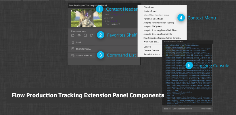

The Flow Production Tracking extension panel uses the same color palette and basic layout as native After Effects panels. It is comprised of five components:
components
  1. Context Header - Thumbnail and fields for the current context.
  2. Favorites Shelf - Designed to show the most commonly-used apps for the current context.
  3. Command List - All non-favorited commands for the current context.
  4. Context Menu - Additional context-related commands and debugging tools.
  5. Logging Console - A console overlay that displays logging output for debugging.

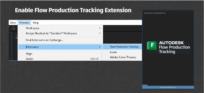

Once the extension is installed, it will need to be launched via the extensions menu in After Effects.
Menu
This will only need to be done once and the Flow Production Tracking extension panel can remain in the After Effects layout without having to be enabled on subsequent launches.
Once enabled, and on future launches, the extension panel will display a loading screen while the Flow Production Tracking integration is bootstrapping.
This screen typically displays for a few seconds before the current context is determined and the commands are displayed.

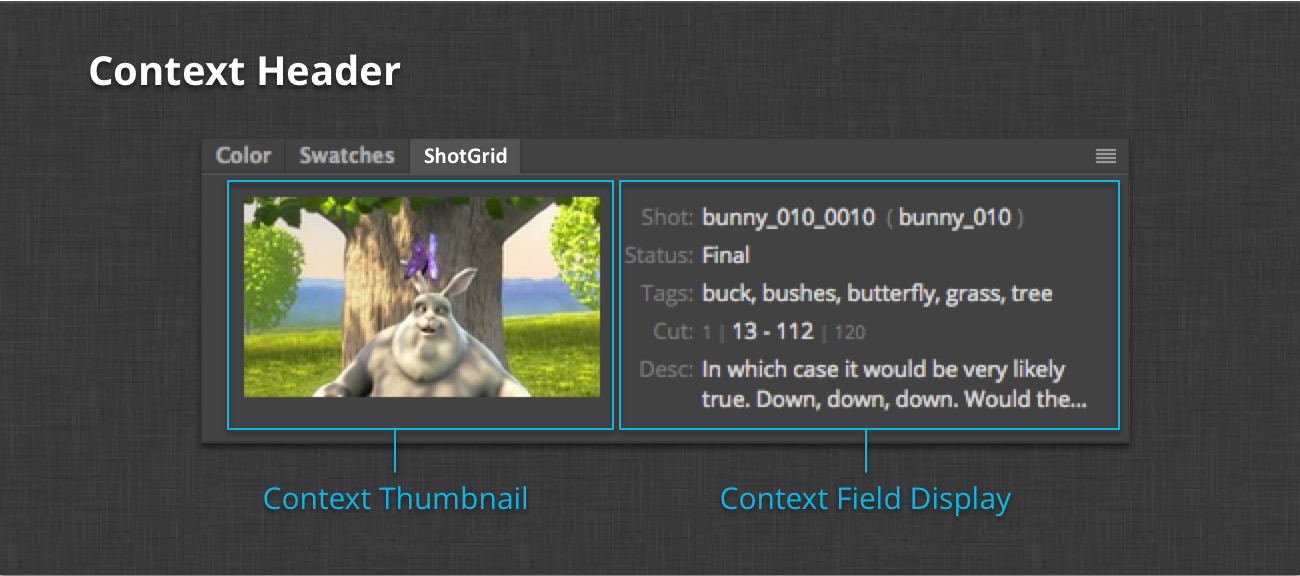

Context header
The context header is a customizable area which can display information about the current Flow Production Tracking context.
Header
The context is determined by the currently-active document. Once the context is determined by the engine, the header will update to display the context's thumbnail field detail. The field information is controlled by a hook. For information on how to customize the field display, see the Context Fields Display Hook section below.
It should also be noted that the context switching will only be recognized in if Flow Production Tracking open was used.

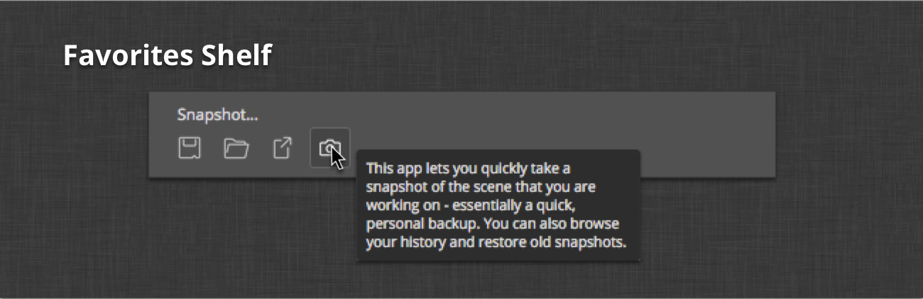

Favorites shelf
The favorites shelf is similar to the menu favorites available in other Flow Production Tracking DCC integrations such as Maya and Houdini. This section of the interface makes the most commonly used Toolkit apps readily available and easy to find just under the context header.
Shelf
The shelf displays the favorited commands as buttons that, when moused over, transition from grayscale to color and display their name in the label at the top. Tooltips for the buttons will show by hovering the mouse above them.
Clicking one of the buttons will trigger the callback for the registered command to execute.
For details on how to specify command favorites, see the Shelf Favorites section below.

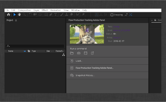

Command list
The command list shows the other "regular" commands that are registered for the current context.
Commands
Typically, apps installed within a pipeline configuration will register one or more commands that are displayed here. If the commands are not identified as favorites, and are not identified as context-menu commands, they will display here.
The command list buttons behave in a manner similar to those in the favorites shelf. The only real difference is that they display as a list with the full name to the right of their icon.

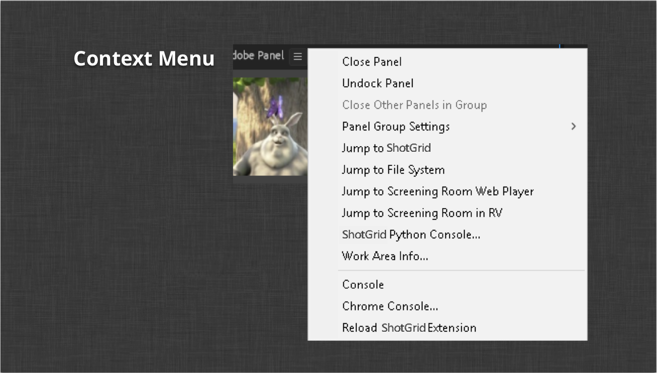

Context menu
Any commands registered as context menu commands will show in the Flow Production Tracking extension panel's context menu.
Context Menu
Like the other command areas, these commands will change along with the context. Commands such as Jump to Flow Production Tracking and Jump to Filesystem will always be available here.

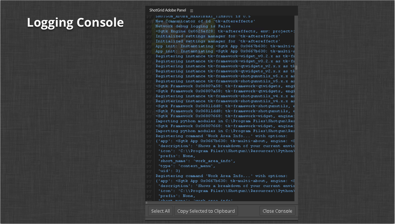

Logging console
The logging console shows all of the logging output from both the CEP Javascript interpreter and Toolkit's Python process.
Console
If there are any issues with the extension that require support, the logging console output is extremely useful for helping the Flow Production Tracking support team debug the problem.
