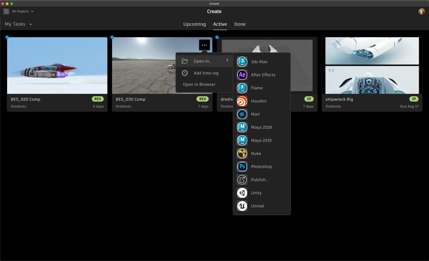

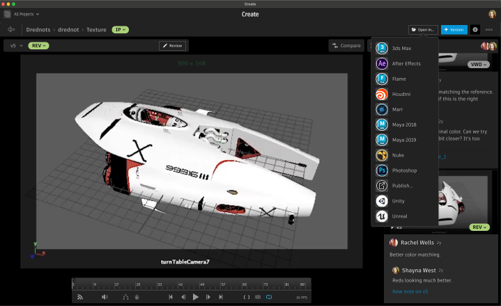

The Desktop2 Engine is the engine which runs inside of the Flow Production Tracking Create Application. It handles DCC launching from Flow Production Tracking Create, as well as from the Flow Production Tracking web application via browser integration.
The tk-desktop2 engine powers Toolkit's integration with Flow Production Tracking Create. The Flow Production Tracking Create provides support for features that users of Toolkit are familiar with, including DCC launching.
