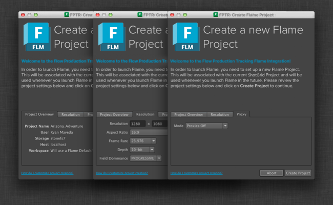

The Flow Production Tracking engine for Flame also helps associate the Flow Production Tracking project with a Flame project, and creates it if need be. This is key to the integration, as it ensures data from Flame gets associated with the right things in Flow Production Tracking. As an added feature, the engine provides functionality for managing the naming conventions of Flame projects as well as the other various settings for the project.
When Flame is launched via Flow Production Tracking for the first time, a Flame project creation UI will appear that lets the artist edit the usual settings from the standard Flame project creation screen:
But with the Flow Production Tracking integration, the settings can be pre-populated with pipeline-friendly values, helping artists quickly get the right thing without having to think about it. The defaults can be customized via the project_setup_hook
, which supports the following options:
