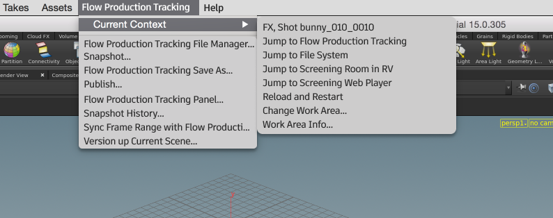

Flow Production Tracking menu
A dynamic menu system was introduced by Side Effects as of Houdini 15, so the engine now supports rebuilding of the Flow Production Tracking menu on context switches.
In Houdini 14 and older, the Flow Production Tracking menu in Houdini is generated before Houdini starts and is static throughout the session. Due to this, the toolkit commands registered in the menu will not update on context changes.

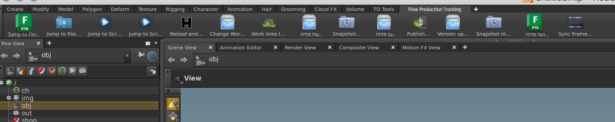

Flow Production Tracking shelf
Release v0.2.4 introduced a dynamic Flow Production Tracking shelf to the engine. The shelf displays any registered app commands as tool buttons. The buttons will be displayed in roughly the same order as the menu commands.
Use the enable_sg_shelf setting to turn on the shelf within an environment. If using a version of Houdini (14 or older) that does not support dynamic menus, you may also want to turn off the Flow Production Tracking menu when using the shelf. This can be done by setting the enable_sg_menu setting to false.
To enable context switching via the shelf, you'll also need to add entity types to the sg_entity_types setting of the tk-multi-workfiles app in your engine configuration.
Here's a look at the settings related to the Flow Production Tracking shelf:
tk-houdini:
  apps:
    # ... other app definitions
    tk-multi-workfiles:
       # ... other app settings
       sg_entity_types: [Shot, Asset] # allow context switching to Shots or Assets
  enable_sg_shelf: true
  enable_sg_menu: false
  # ... other engine settings

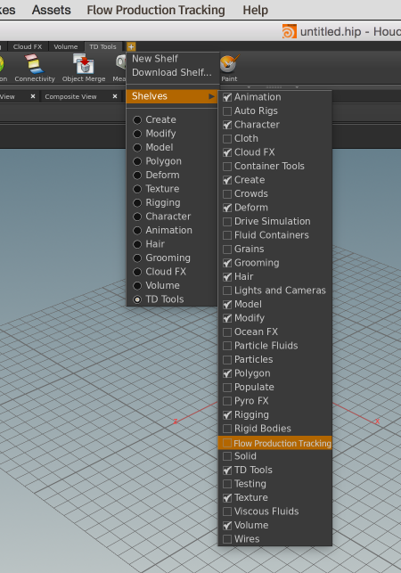

Once you've enabled the Flow Production Tracking shelf, you need to manually add it to a shelf set inside houdini.
Add the Flow Production Tracking shelf
Once added to a shelf set the Flow Production Tracking shelf will remain there between houdini sessions and will update dynamically as your Flow Production Tracking context changes.

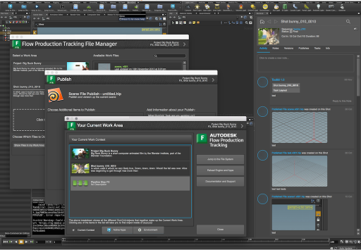

Panels
As of v0.2.8 the engine adds support for embedded toolkit panels.
The panel support currently requires Houdini version 15.0.272 or later for proper embedded panels. Registered panels will show up as panes in the pane menu for supported versions of Houdini.
Older versions of Houdini will display the registered panels as dialogs. SESI may backport some bug fixes to newer builds of Houdini 14. If and when that happens, we will make embedded panels work for those versions as well.
