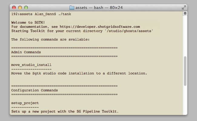

The Flow Production Tracking engine for the shell handles command line interaction and is tightly integrated with the tank
command which is distributed as part of the Core API. When you execute the tank
command in a terminal, Toolkit launches the engine to handle app execution.
For more information about the tank command, please see our Advanced Toolkit Administration documentation.
