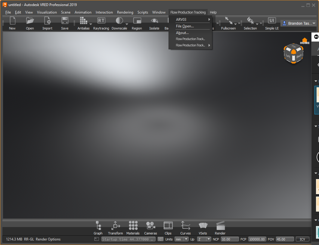

When VRED opens, a Flow Production Tracking menu (the VRED engine) is added to the menu bar.
menu

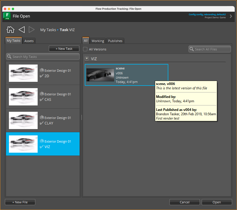

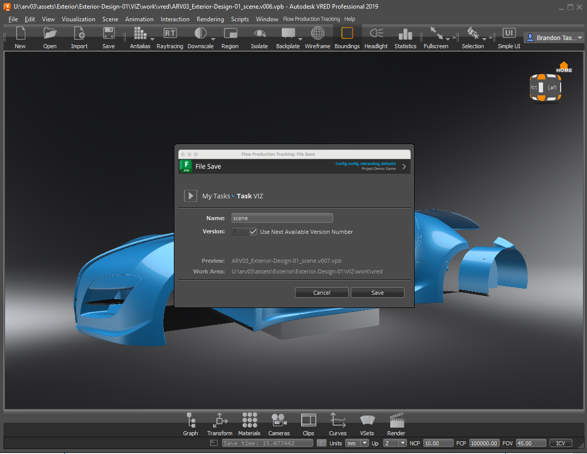

File Open and Save
Use the My Tasks and Assets tabs to see all your assigned tasks and browse for assets. To the right, use these tabs to view all files, working or published files associated with what is selected to the left.
file open
file save

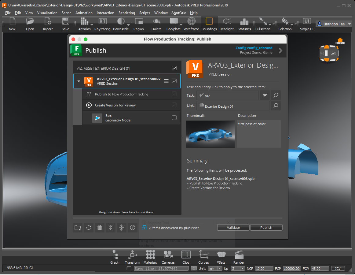

Publish
Publish: Opens the Publish dialog for publishing the file to Flow Production Tracking, which can then be used by artists downstream. For more information on VRED Publishing, see here
publish

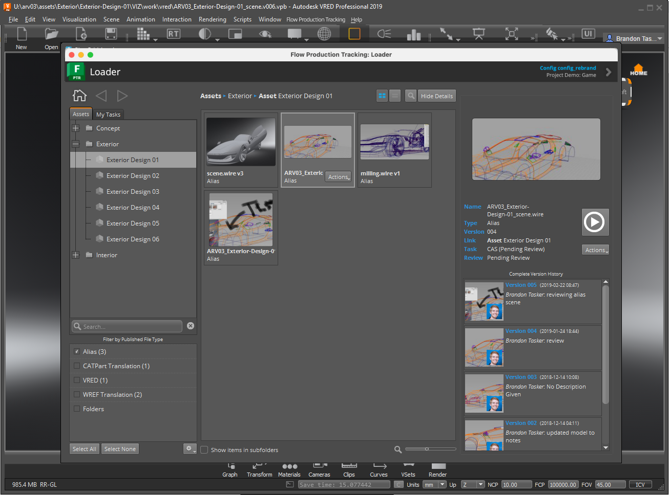

Loader
Load: Opens the Content Loader app, along with instructional slides explaining how it works. To see more info about VRED loading see here
loader

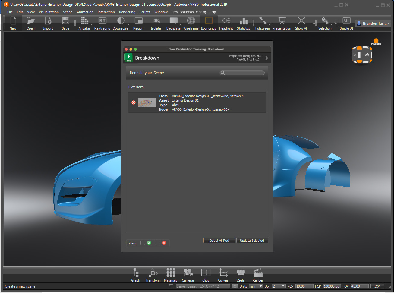

Scene Breakdown
Scene Breakdown: Opens the Breakdown dialog, which displays a list of "referenced" files (and their links), along with what in the scene is out-of-date or using an alternate version of the PublishedFile.
breakdown
