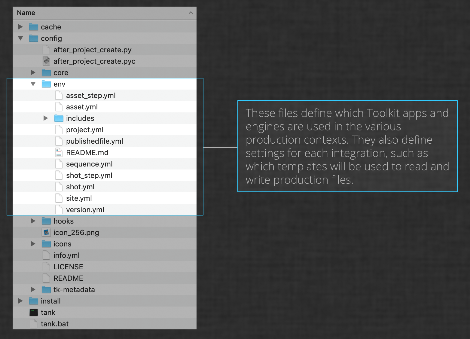

Within your Pipeline Configuration, the config/ directory contains all the files and folders that are meant to be customized. In config/, you’ll find three sub-directories: cache, core, and env. The env directory holds the environment configuration files, so this document will refer to the files in config/env.
env Folder Contents
In the Default Configuration, you’ll see the following files in config/env/:
asset.yml
asset_step.yml
project.yml
sequence.yml
shot.yml
shot_step.yml
Each of these files corresponds to an environment; having separate files allows each environment to be configured separately.

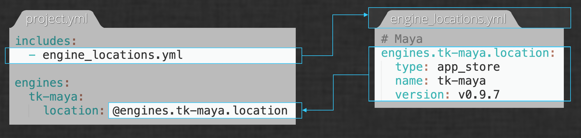

Includes
Includes allow you to reference a section of one file in another file in your configuration. Using includes allows you set a configuration setting in one place, but use it in multiple environments.
Includes consist of two parts:
  • The includes list: a YAML dictionary whose key is includes, and whose value is a list of all files we want to include from.
  • A reference within your configuration settings, prefixed by the @ symbol, and named to point to the name of the section you want to reference from the included file.
To flesh out our above example, you might have a single file where you hold the location descriptors for all of your engines. Let’s put that file in an includes subfolder, and call it engine_locations.yml.
The contents of engine_locations.yml would look like this:
config/env/includes/engine_locations.yml:
engines.tk-maya.location:
  type: app_store
  version: v0.9.4
engines.tk-nuke.location:
  type: app_store
  version: v0.11.5
This file can act as a single source for all engine locations, and all of your environment configurations can reference it. Using this include file, our example now looks like this:
config/env/project.yml:
includes:
- includes/engine_locations.yml
engines:
  tk-maya:
    apps:
      tk-multi-about:
        location:
          type: app_store
          version: v0.2.8
      tk-multi-shotgunpanel:
        location:
          type: app_store
          version: v1.6.3
      tk-multi-workfiles2:
        location:
          type: app_store
          version: v0.11.8
    location: @engines.tk-maya.location
engine_locations include file
You can see here that the value of the location setting for the tk-maya engine is now a reference to a key from the included YAML file.
