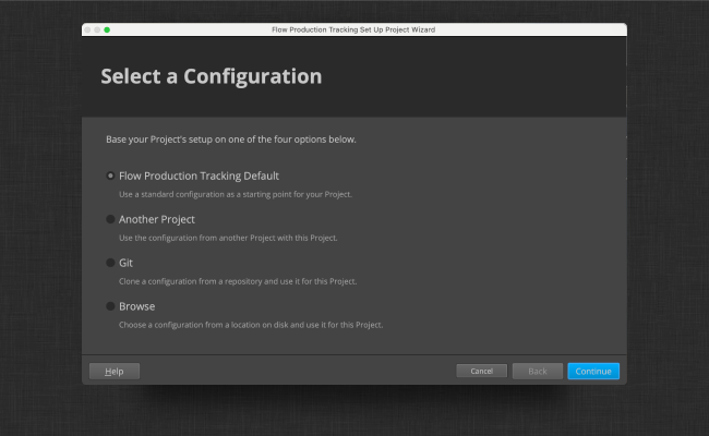

SetupProjectWizard API Reference
This is a QWizard implementation that walks somebody through setting up a Project from their Flow Production Tracking instance for Toolkit. To use the wizard, simply create an instance of the class, passing in the project to setup (as a standard Flow Production Tracking API entity dictionary) and the window to parent to.
adminui = sgtk.platform.import_framework("tk-framework-adminui", "setup_project")
setup = adminui.SetupProjectWizard(project, parent)
dialog_result = setup.exec_()
This will run the wizard and return a standard QDialog Accepted or Rejected value.
