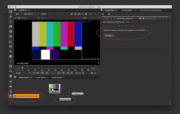

The Quickreview app makes it easy to submit Nuke renders for review in Flow Production Tracking. A Version in Flow Production Tracking will be created with each quickreview submission. It appears as a node in Nuke, located on the Flow Production Tracking Node menu. Simply create a new node, attach it to your Nuke network, double click it and click the Upload button.

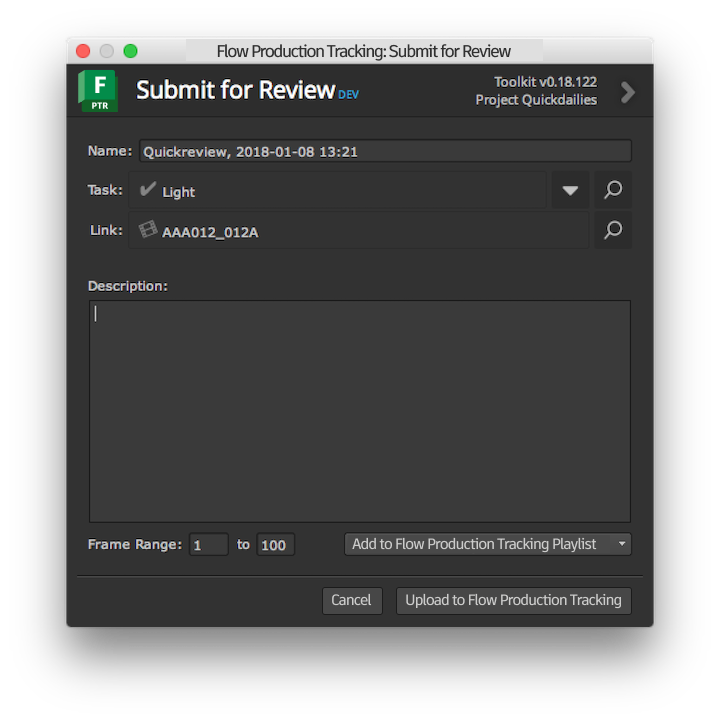

You get presented with the following UI, allowing you control how your Version is created in Flow Production Tracking:
The following items can be controlled:
- The version name is pre-populated based on the currently loaded nuke script and can be adjusted if needed.
- The entity link and task associated with the version is based on the current context and can be adjusted.
- The frame range to be submitted can be adjusted.
- The created Version can be added to a playlist. A dropdown with recent playlist are being displayed.

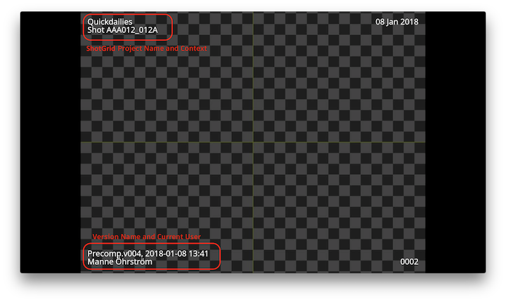

Burnins and slate
By default, the app will generate a Quicktime with a slate and burn-ins:
