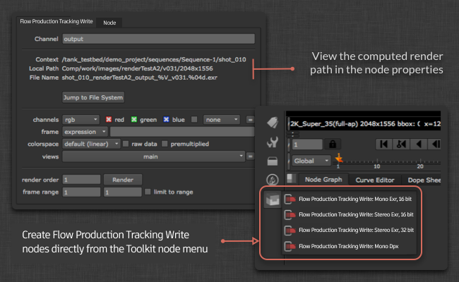

General Use
In order to use the Flow Production Tracking Write Node, save your script as a Toolkit work file first and then create a new node via the Nuke menu. This will create a node which looks similar to a normal write node:
Rather than entering a path by hand, you just specify an output name and Toolkit will then compute the rest of the path automatically. You can see the computed path in the UI and open up the location on disk by clicking the Show in File System button. The location where the renders are written to depends on the Toolkit configuration.
The renders will be versioned and the version number will always follow the current nuke script version which will be incremented automatically when you publish using Multi Publish.

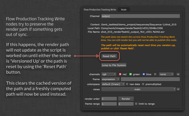

Resetting the render path
The Write Node will cache the current path so that it is still valid if the file is opened outside a Toolkit Work Area. Occasionally, this can mean that the path becomes out of sync and 'locked'. If the render path is locked then renders created with this Write Node cannot be published.
To reset a render path, either version-up the scene using the Work-files app's 'Version Up Scene' command or select the Write node individually and in the properties, click Reset Path:

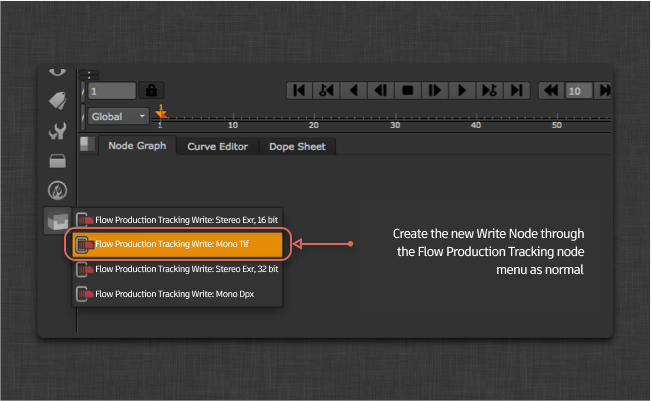

Adding Another Write Node Profile
The Flow Production Tracking Write Node wraps Nuke's built-in write node, so any format supported by Nuke can be used with the app and additional nodes can be added via configuration. The simplest way to start is to set up a simple Nuke write node with the parameters you want. For the example, let's imagine you are doing 16-bit tifs with LZW compression. If you look at your Nuke script in a text editor, the write node will look something like this:

The updated configuration will then result in the additional Flow Production Tracking Write Node appearing in Nuke:

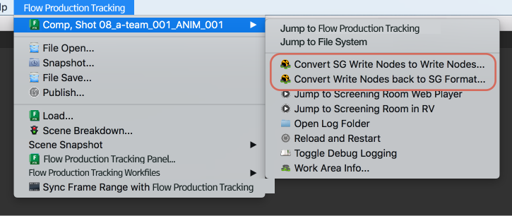

Enabling the convert menu options
There is a configuration option called show_convert_actions
that can be added to the app's settings in the environment yml files. When you add the setting show_convert_actions: True
, the Convert SG Write Nodes to Write Nodes... and Convert Write Nodes back to SG format... menu options become available.
However if you have any Flow Production Tracking Write node profiles defined that promote write knobs, then these menu options will be hidden even if the show_convert_actions
is set to True
. This is because at present the convert back functionality does not support promoted knobs.
