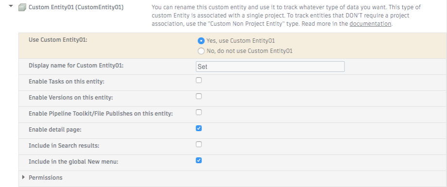

Enabling a custom entity

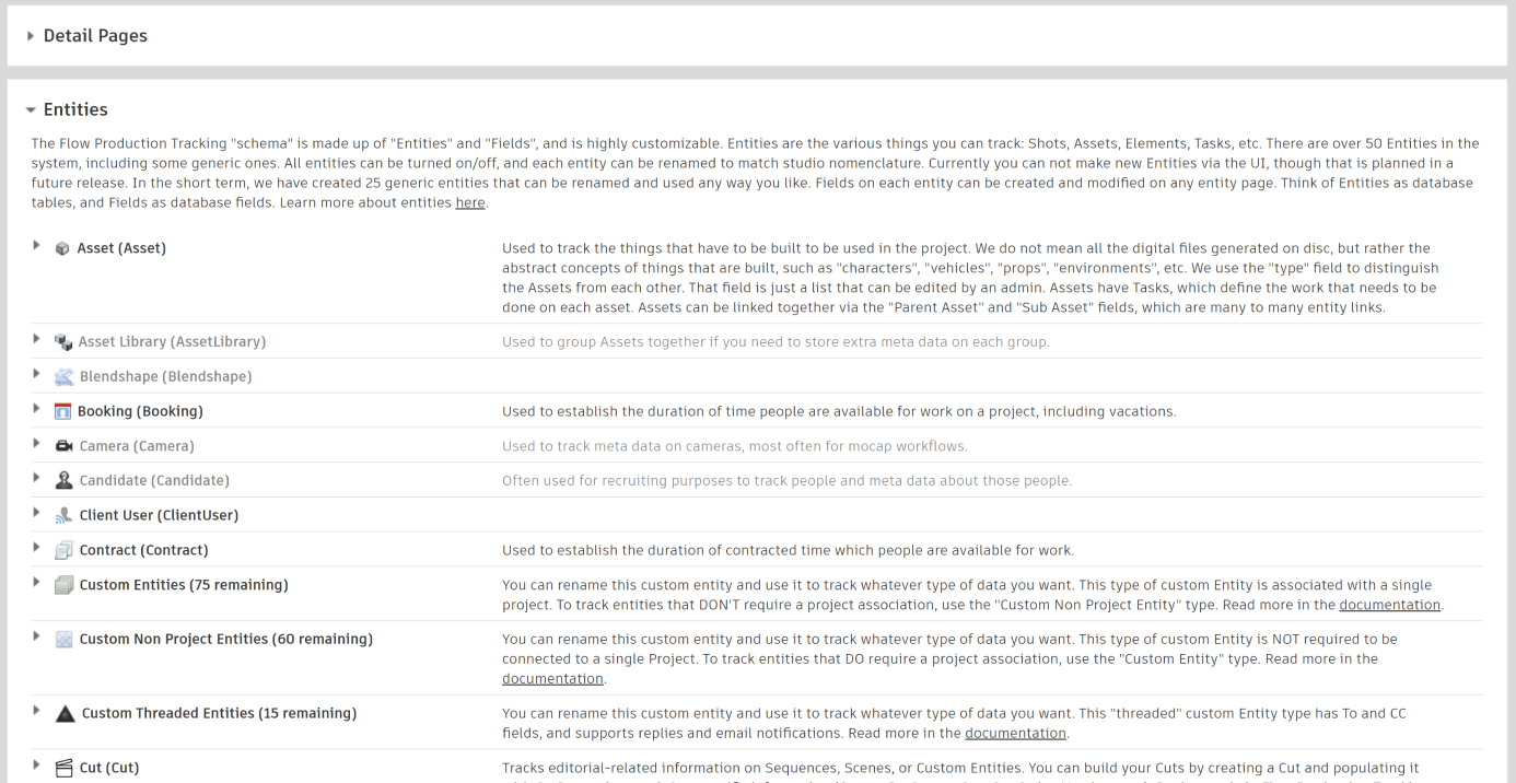

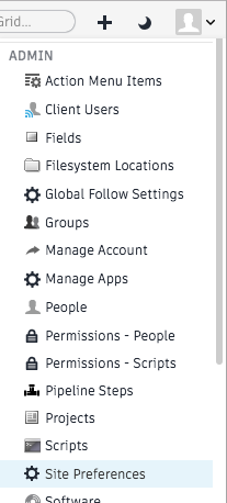

Step 1: Open your Flow Production Tracking site in the browser. Click on your avatar and go to ADMIN > Site Preferences. In the resulting page, expand the Entities section.
Displayed is a list of entity types that are available in Flow Production Tracking. At the top of the list in the image below are some entity types that are configured for the current Flow Production Tracking site. Underneath these entity types are several Custom Entities that are not configured or enabled.
Choose one of the custom entity types, configure it, and enable it.
Step 2: Select the arrow to open the settings on a grayed out disabled custom entity. Select the radio button next to Yes, use Custom Entity…, change the Display name to Set then scroll to the top of the window and select Save Changes.
Doing this makes that custom entity active in Flow Production Tracking and gives it the display name Set. Essentially you are creating an alias for the custom entity because the system name of the entity remains CustomEntity01. In this example, we're using CustomEntity01; you might use a different custom entity.
Remember the system name of the custom entity you chose.

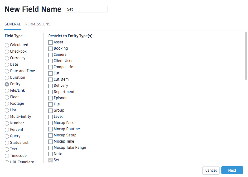

Add a data field to associate assets with sets
Adding a data field to the Asset entity enables us to link assets to the new entity. The assets the artists create for the dining room will be associated with the Dining Room set entity.
Step 3: Select the Projects dropdown at the top of the page to open the project you want to use for this exercise.

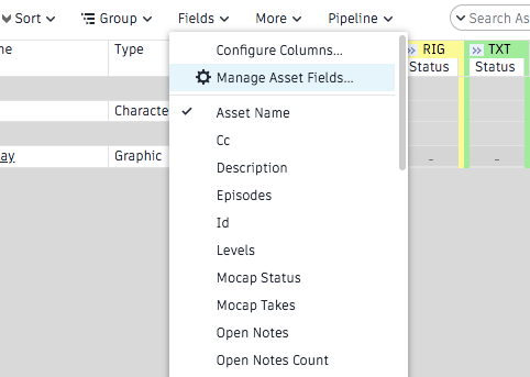

Step 4: Select Assets in your project menu bar to go to an Assets page. In the Assets menu, select Fields > Manage Asset Fields…

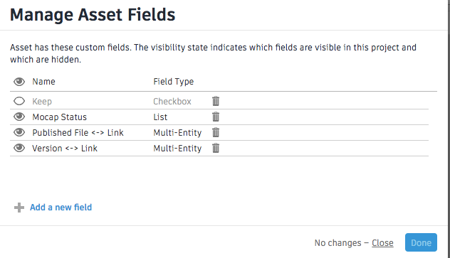

This action displays the asset field manager.
Select + Add a new field
Select the parameters for the new field.

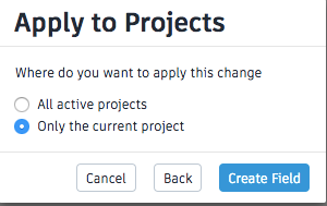

In New Field Name, type “Set”. In the GENERAL menu under Field Type, select Entity and scroll down to Restrict the type to Set. Select Next.
For this guide, apply it to Only the current project and select Create Field.
Flow Production Tracking will configure the new field.
Your change has been applied and you can select Done.

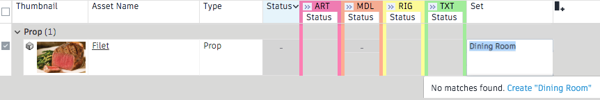

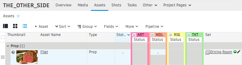

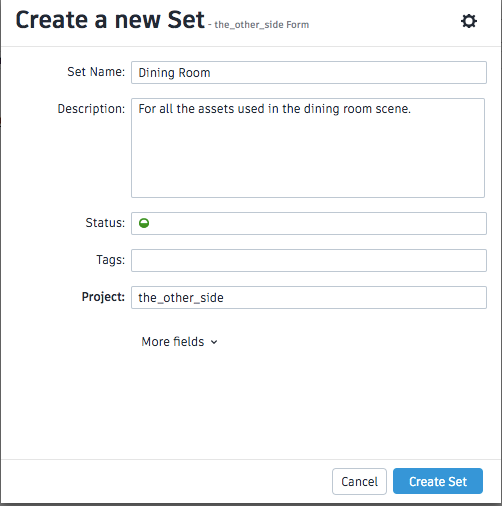

Step 5: Select the new Set field of an asset and start typing Dining Room. A dialog box is displayed stating, No matches found. Create “Dining Room”
Select Create “Dining Room”.
Select Create Set.
Adding Dining Room in the Set field of an asset creates an association with the Dining Room set entity.

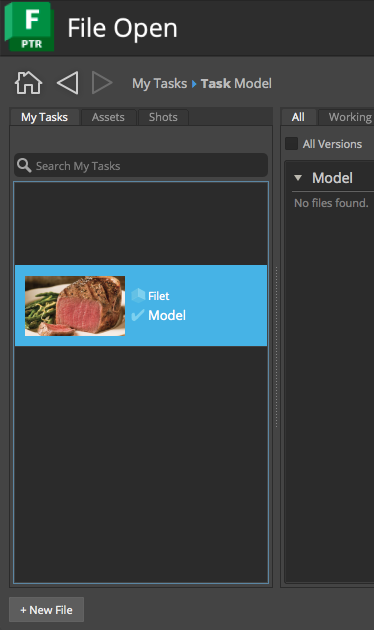

Step 6: Assign the Model task on the filet asset to yourself, so you can find it easily for testing purposes.

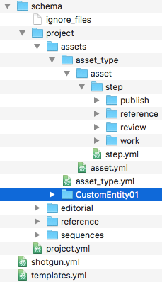

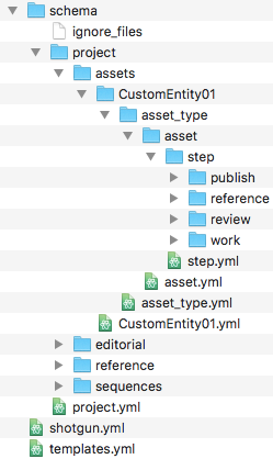

Create the new folder and YAML file for the Set entity
The schema has a project folder that contains folders relative to the different entities Flow Production Tracking tracks. You are adding the new asset entity, CustomEntity01, to enable Flow Production Tracking to track the items in a Set. These items are assets, so you will edit the folders and YAML files under assets.
Again, our goal is to go from an asset_type/asset/step folder structure to set/asset_type/asset/step. So, we’ll want to add a folder to represent set in our schema, with a corresponding YAML file. Since we need to use the system name for custom entities, we’ll be creating the CustomEntity01/ folder and CustomEntity01.yml.
Step 8: Add a CustomEntity01 folder inside the project/assets folder of your schema.
Step 9: Create a file called CustomEntity01.yml file next to the CustomEntity01 folder, with the following contents:
type: "shotgun_entity"
entity_type: "CustomEntity01"
filters:
- { "path": "project", "relation": "is", "values": [ "$project" ] }
The YAML file will give the instructions to Toolkit for what to name the CustomEntity01 folder. In this case, we’re making a folder of type Flow Production Tracking_entity, which means that it corresponds to a Flow Production Tracking query. The entity_type field tells us to query the CustomEntity01 entity in Flow Production Tracking, and the name field tells us which field on the entity to query – in this case we’re getting the code field from CustomEntity01.
The filters field limits the cases in which this dynamic folder should be created.
Step 10: Move asset_type/ and asset_type.yml into the CustomEntity01 folder
As we want our folder structure to look like Dining-Room/Prop/filet, the asset_type folder should be below the CustomEntity01 folder in our hierarchy. Move asset_type/ and asset_type.yml into the CustomEntity01 folder.

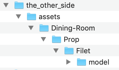

Step 12: Run tank folders on the filet asset. From your terminal, run the following:
> cd <pipeline_configuration_root_folder>
> ./tank Asset Filet foldersAbridged output:
Command: Folders
Creating folders, stand by...
The following items were processed:
- /Users/michelle/Documents/Shotgun/projects/the_other_side
- /Users/michelle/Documents/Shotgun/projects/the_other_side/assets/Dining-Room
- /Users/michelle/Documents/Shotgun/projects/the_other_side/assets/Dining-Room/Prop
- /Users/michelle/Documents/Shotgun/projects/the_other_side/assets/Dining-Room/Prop/Filet/
- /Users/michelle/Documents/Shotgun/projects/the_other_side/assets/Dining-Room/Prop/Filet/model
- /Users/michelle/Documents/Shotgun/projects/the_other_side/assets/Dining-Room/Prop/Filet/model/publish
In total, 23 folders were processed.The final structure matches what was expected, and Toolkit is so smart that it even added a dash between Dining and Room.

Edit the template to match the path in the filesystem schema
Step 16: Search for asset_root at the top of the paths section of templates.yml. In the Default Config, it looks like:
asset_root: assets/{sg_asset_type}/{Asset}/{Step}
Add CustomEntity01 to the asset_root path to match the schema modifications:
asset_root: assets/{CustomEntity01}/{sg_asset_type}/{Asset}/{Step}

Test it

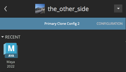

Step 18: Launch Maya from Flow Production Tracking Desktop.

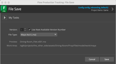

In Maya, go to Flow Production Tracking > File Open, and in the resulting dialog, select a task on an asset for which you’ve specified a Set in Flow Production Tracking.
Select +New File.
You can create a simple 3D object or just save the file using the Flow Production Tracking > Save File.
Success!
Notice the File Save dialog box is displaying Preview: Dining-Room_scene.v001.ma using the new settings in the template.
The Work Area: is displaying .../Flow Production Tracking/projects/the_other_side/assets/Dining-Room/Prop/Filet/model/work/maya as the path for where Workfiles is saving the file.
