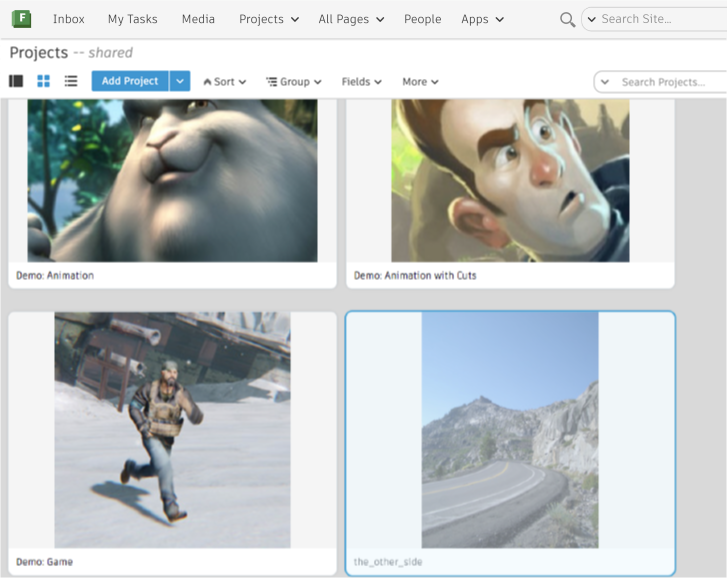

Step 1: Open the Flow Production Tracking site that manages the project you will be using for this exercise.
Step 2: Access the project from the Flow Production Tracking site by selecting it from the Projects page.

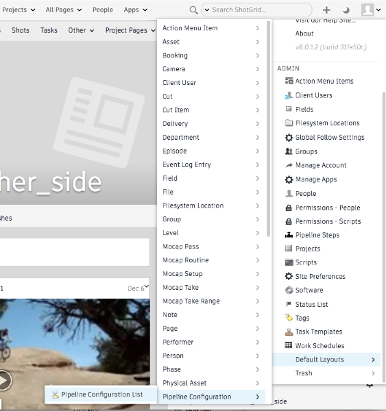

Step 3: Select the avatar in the upper right to display the ADMIN menu and scroll down to select Default Layouts > Pipeline Configuration > Pipeline Configuration List.

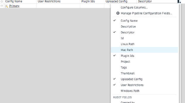

Step 4: Once the Pipeline Configuration List is displayed, select the + sign on the far right of the column headers to add another column. In the dropdown list, choose the appropriate path for your operating system.
The path will be displayed in a new field.

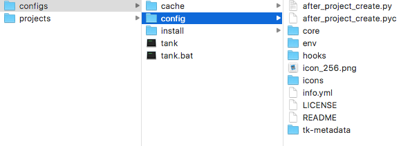

Step 5: In a terminal or file manager, browse to the folder where the project’s pipeline configuration is stored and open the folder.
There are three subfolders in a Toolkit configuration root folder: cache, config and install. Open the config folder and nested inside you will find several subfolders and a few files.
The env folder stores the integration settings that support the environments artists work within. Environments allow different stages in the pipeline to have a customized configurations. The Default Configuration comes with a set of pre-defined environments, but these can be modified if your pipeline requires a more granular set.
Step 6: Open the env folder.

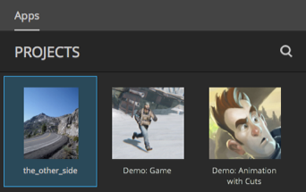

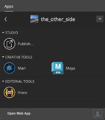

Step 7: Open Flow Production Tracking Desktop.
Step 8: Select the project whose configuration you are going to edit.
Step 9: Launch Maya from Flow Production Tracking Desktop.

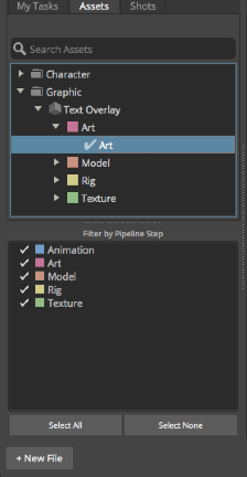

Step 10: Select the Assets tab in the left pane of the File Open dialog box. Select any asset inside the folder displayed in the search results.
The +New Task button is enabled.

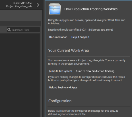

Step 11: Select the > at the top right of the File Open window next to Project (name of project).
This reference box shows details about the configuration settings that control the functions of the File Open window. Some apps in Toolkit have a reference box to show what settings are used for the app and what the default settings are. Notice the Location:: identifier is tk-multi-workfiles2. This is the identifier for the bundle of code that creates the Workfiles app. When searching a pipeline configuration this name will identify where the settings live for the app. There’s an Apps and Engines page that lists all the configuration settings, apps, and engines for what’s available in a Flow Production Tracking Integration.

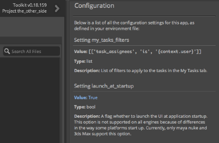

Look under the Configuration header to find the settings for this specific environment.
After the setting my_tasks_filters is a setting launch_at_startup. This is important to note because it’s the default setting for the File Open setting in the project environment. This tells you that when Maya is launched from Flow Production Tracking Desktop App, the File Open dialog automatically opens.

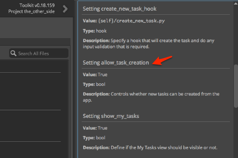

Scroll down to Setting allow_task_creation. The default value of this setting is True, allowing a user to create a new task while in the Maya project environment.

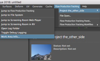

Step 13: Find the Flow Production Tracking menu item in the upper right of the Maya window.

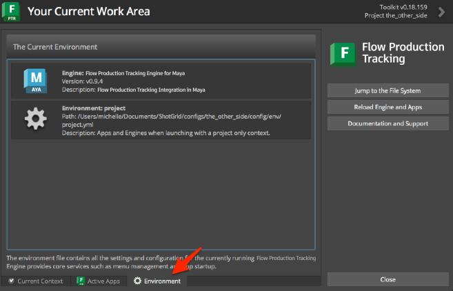

Step 14: Select Flow Production Tracking > Project the_other_side > Work Area Info… on the top right of the menu.
The Work Area Info dialog box shows what’s under the hood and details about your current work area. This includes the environment that you are is working in and the path to the environment configuration file where the settings are located.
Step 15: In the Your Current Work Area dialog box, select the Environment tab at the bottom.
The first item identifies the engine being used. The engine is what drives the ability to have the Flow Production Tracking tools integrated within a specific software application. It holds the logic specific to each software integration. The second item displayed in the window shows the path where the current project environment is located.
The last two folders are config/env/ followed by project.yml. The project.yml file is the start of the roadmap that will guide you to where the settings for the current environment are located.

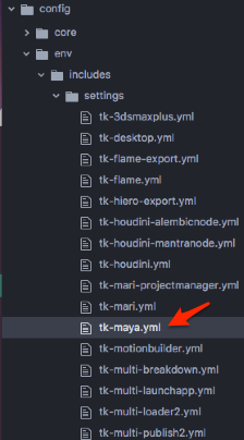

Step 17: In your file browser, browse to the env/includes/settings folder and open tk-maya.yml.
Step 18: Following the include from project.yml, search the tk-maya.yml file for settings.tk-maya.project. You are specifically looking to disable the +New Task button in the project environment of a specific project. You are in the configuration for that project and obtained the location information while you were in the project environment.

The Maya reference box indicated the allow_task_creation setting has a default value of true. As a best practice, no default settings are reflected in a pipeline configuration. This allows for a sparse format, adding only the settings that differ from the default code to the configuration. If a setting isn’t explicitly provided, any calls accessing that setting will receive the default value. When Toolkit reads the configuration and builds an environment, the apps, engines, and frameworks running in that environment use that project’s pipeline configuration settings and override any default settings based on what’s in the configuration.

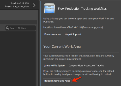

Step 22: In the File Open dialog box inside of Maya, open the reference box and select Reload Engines and Apps.
This will reload the configuration settings.

Step 24: Under the Assets search results, open a folder and select asset you wish to work on.
Step 25: Select +New File
By selecting +New File, you began to work on a new asset and the asset_step environment was loaded in Maya. When an artist selects an asset task and creates a new file or opens an existing one, the asset_step environment is automatically loaded, presenting the tools and functions configured for that stage in the pipeline.

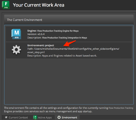

Step 27: Select Art, Asset Text Overlay > Work Area Info... to display what the parameters are in your current work area.
Step 28: Select the Environment tab at the bottom.
Each environment will display the information necessary to determine where the settings live in the pipeline configuration. To disallow an artist from adding a new task, it’s necessary to disable the +New Task button for every environment that artist works in. For each environment, use the same steps outlined above to edit the configuration appropriately.
