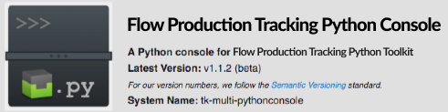

Step 1: Open the Apps and Engines page and find the information for the Flow Production Tracking Python Console under Maya. Select the title.
This will bring up the information for the app, which includes everything that’s needed for the little black book.
The System Name is the main identifier: tk-multi-pythonconsole. You will also need the Latest Version: v1.1.2.

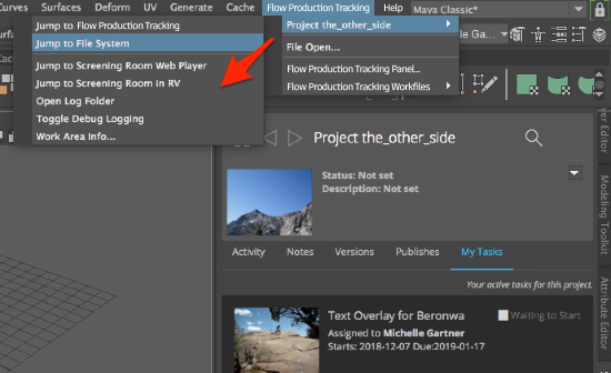

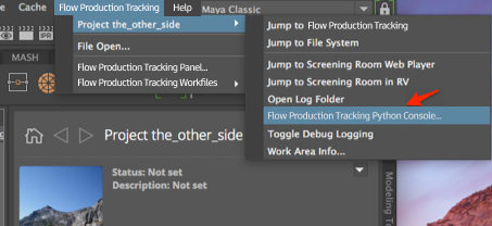

Confirm that there’s no Python Console app in the Project environment in Maya
Step 2: Launch Maya and select the Flow Production Tracking Menu, Flow Production Tracking > Project the_other_side and you will see the list of apps that are available for that project in the Project environment.

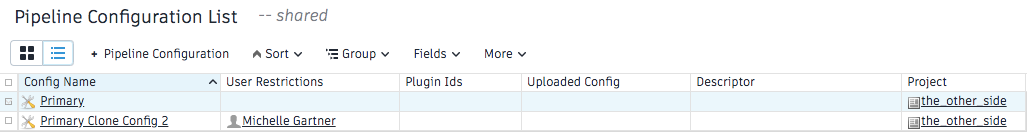

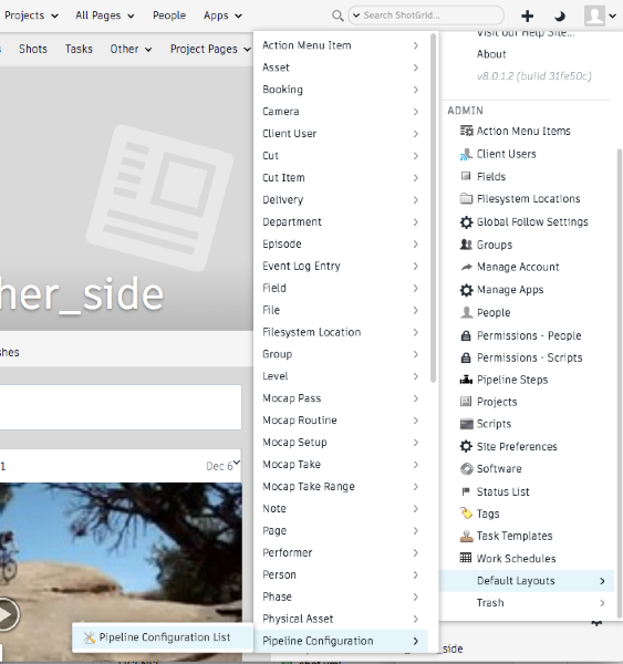

Go to the Pipeline Configuration list.
Step 3: Open Flow Production Tracking and in the upper right, select the Admin Menu (your avatar) > Default Layouts > Pipeline Configuration > Pipeline Configuration List.
This action displays a detailed list of all of your Flow Production Tracking site's pipeline configurations.

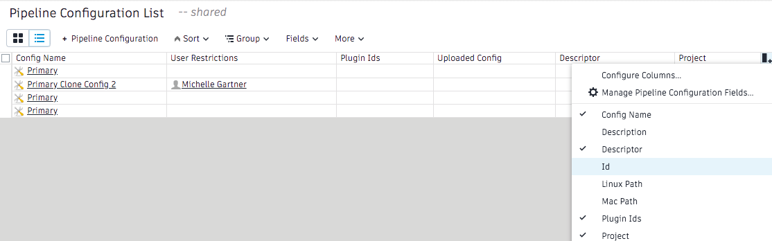

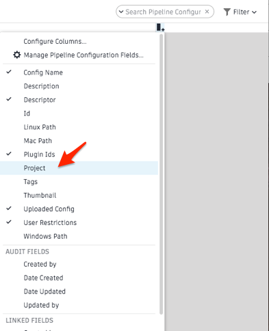

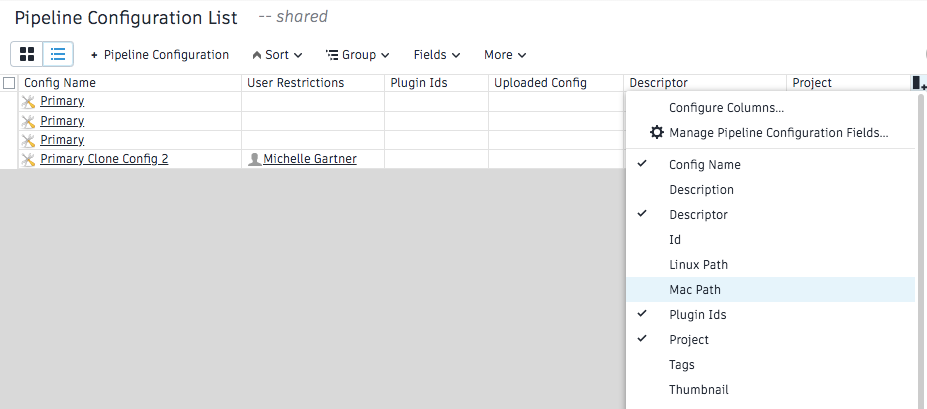

Step 4: Once the Pipeline Configuration List is displayed, select the + sign on the far right of the column headers, and add the column Projects.

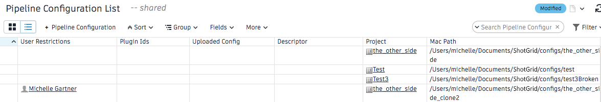

Review where the project’s configuration is located
Step 5: Additionally, add the the appropriate Path field for your operating system.
This displays the paths to the configuration files.

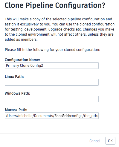

Step 6: Right-click in the empty space next to the Primary line item and select Clone this Configuration… in the context menu.
Step 7: Name the configuration in the Configuration List and name the file in the directory: "Primary Clone Config 2" and “the_other_side_clone2,” respectively. Select OK.
Wait while Flow Production Tracking copies all of the files and folders in the configuration and creates a cache for the apps. Now would be an opportune time to use an app that makes you a light, fluffy, melt in your mouth croissant to go with that perfect shot of espresso.

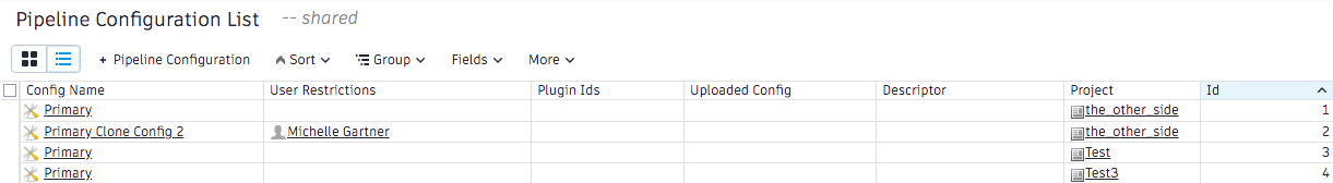

When completed, the Configuration List will be updated with information about the cloned configuration and there will be a new configuration added to your local config folder.
Under User Restrictions your user name was added. Flow Production Tracking automatically restricts access to the new configuration to only the person who created the configuration. You can add people you want to edit, test, and eventually use this configuration. Yet another way Flow Production Tracking allows for flexibility and control.

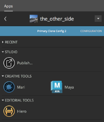

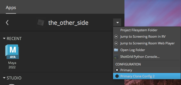

Step 8: Open Flow Production Tracking Desktop and select the project you created the cloned configuration for. Select the down arrow in the upper right to display the configurations associated with this project and select the Primary Clone Config 2 that you just created.
Flow Production Tracking Desktop is now using the cloned config for this project.

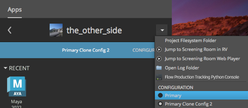

Step 16: Open Flow Production Tracking Desktop, select the project you were working with, and confirm you are using the cloned configuration.
There will be a blue bar with the name of the clone that you created under the name of the project.
If you’re using the primary, there will be no blue bar and the configuration name won’t be visible.
Step 17: Launch Maya from Desktop and select the menu Flow Production Tracking > Project > …
If:
- You’re using the cloned configuration that you just edited
- The cloned configuration was extended correctly
- You saved the extended files
- You chose to associate the project with the cloned configuration
- You relaunched Maya from Flow Production Tracking Desktop
The Python Console app will be available in Maya.

There will be a list of the available pipeline configurations that the cloned configuration can be pushed to. Enter the ID of the primary pipeline configuration for the project you are updating the configuration for.
You can also find the id for your Pipeline Configuration on the Pipeline Configuration page in Flow Production Tracking that we viewed in Step 3 of this guide. To find the project ID, go to the Configuration List and add the ID column.

Please type in the id of the configuration to push to (ENTER to exit): 1
Hold on, pushing config…

Step 19: In Flow Production Tracking Desktop, click on the arrow in the upper right and choose Primary in the CONFIGURATION list.
Step 20: Launch Maya from Desktop and look in the menu Flow Production Tracking > Project > … to find the Flow Production Tracking Python Console...
The Python Console app was added to the Project environment for the chosen project. We discussed in the second guide, “Editing a configuration, that each environment is independent, a project has a dedicated configuration, and the software integrations gather settings from the pipeline configuration when a project is loaded. For the Python Console to be available in an environment, that environment will need instructions to look in the app_locations.yml file for the location descriptor. Given this, at any point in the pipeline where you want the Python Console app to be available will need the settings that say, “use the Python Console app here.”
