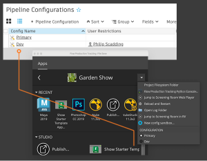

Part 1: Creating a development sandbox
Before you do anything else, we recommend that you set up a development sandbox by cloning the project configuration by cloning your project's configuration. This will result in a separate configuration where you can develop your code and test changes without affecting anyone else on the production.

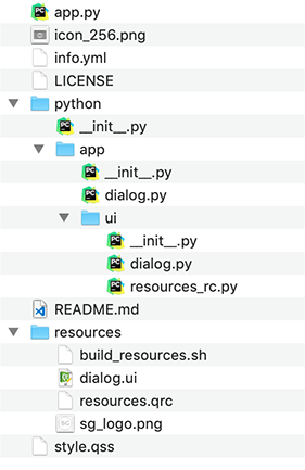

Anatomy of the Template Starter App
The template starter app contains the following basic structure:
- app.py - The app entry point and menu registration can be found in the
app.pyfile. This is where you typically set up your classes, get things initialized, and get menu items registered. - info.yml - Also known as the manifest file. It defines all the different settings that this app requires when it is installed, along with their default values if supplied. Settings are often useful if you want reusable apps and you don't want to hard code any values in the app itself.
- python/app/dialog.py - This contains the logic, event callbacks, etc. that produce the main app window.
- python/app/ui - This folder contains the automatically generated UI code and resource file. You don't edit this directly; instead, you edit the Qt UI file in the
resourcesfolder. - resources/ - In the resources folder, the
dialog.uifile is a Qt Designer file that you can open up and use to rapidly design and define the look and feel of the app. Once you have made changes, you have to execute thebuild_resources.shscript, which will convert the UI file to python code and store it as/python/app/ui/dialog.py. - style.qss - You can define QSS (Qt style sheets) for your UI in this file.
An app doesn't need to have a UI however, and the minimum requirements for a valid app are an app.py containing an Application class and an info.yml.

Part 5: Testing
When you want to test your code, you can easily invite other users to your dev sandbox by adding them to the User Restrictions field on the PipelineConfiguration entity in Flow Production Tracking.
As soon as you have added a user, they will see new entries on their menus inside of Flow Production Tracking Create and the browser actions, as well as an option to pick the configuration inside of Flow Production Tracking Desktop.
Make sure they have access to see your app code as well, otherwise the app will not load.
